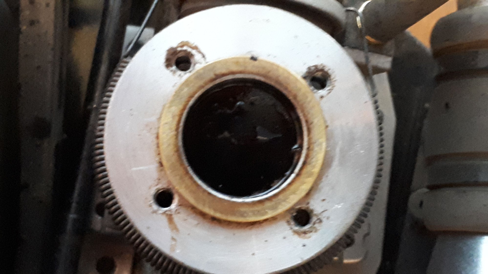

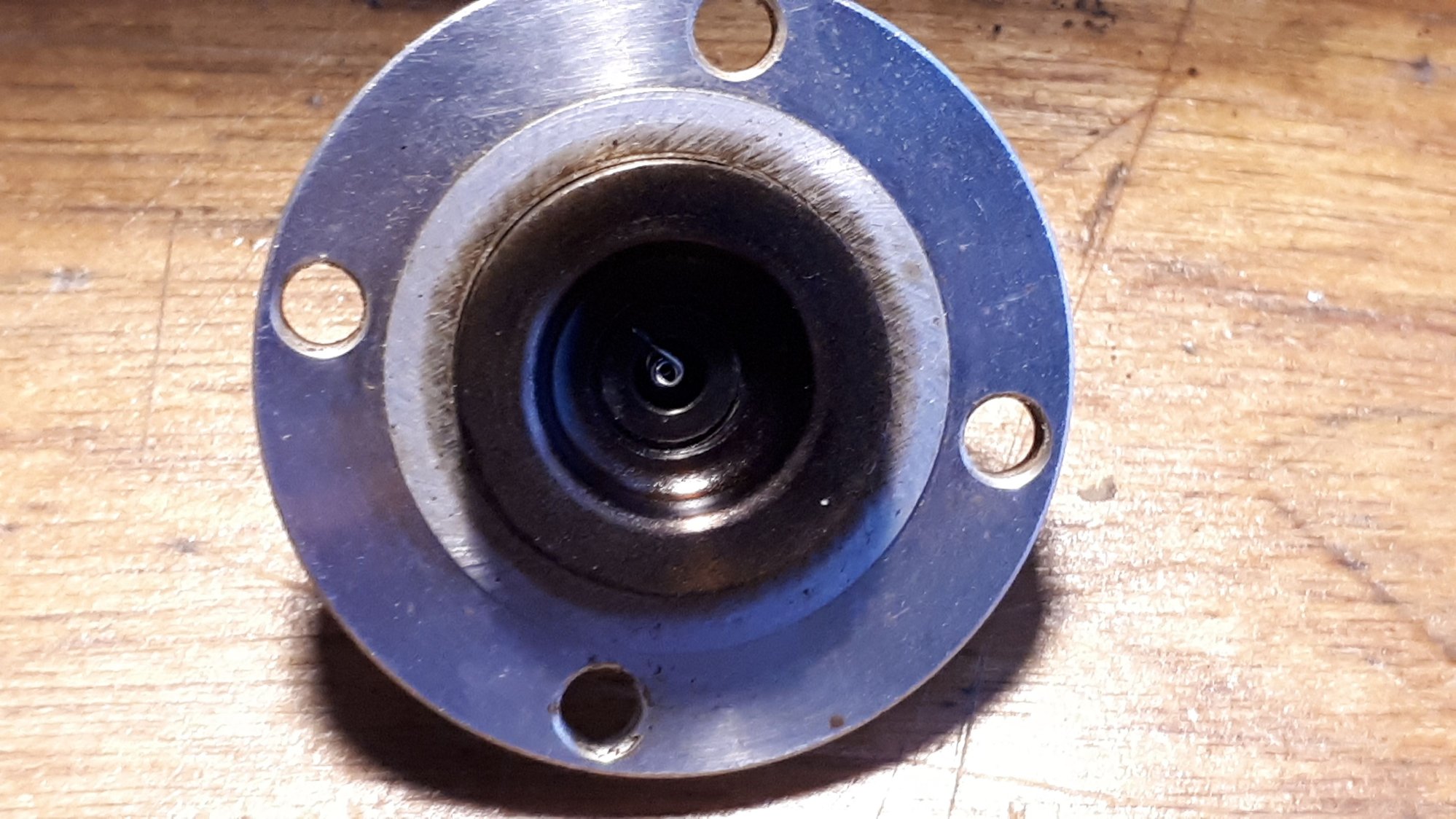

this is my motor.

the top of the piston is black.

By the looks of the pictures looks like your top end needle is in pretty far. Not enough fuel and your burning the plug up. What about the low end needle on the other side? How far is that in? Might want to start from the factory settings and start over.
thank you very much, I will do as you say and go back to zero. for the low end needle I'm not touching it.

Engine needs to be cleaned REAL BAD!! Looks like you have been all over the place with engine tune.. Carbon/dirt is flaking off the top of the piston..That will knock out a plug real quick. There is no zip tie on our carb boot??? Those engine can be had pretty cheap online. You may want to purchase a new one and start over. My guess is the piston and crank pin are in ruff shape. You may be fighting a battle that's to late to win!!! Cut bait and start over. Are you running basher fuel or race fuel ? Also look into proper air filter maintainance this will help extend the life of our engine

Very lean for a long time. Black is bad!!!!!!!!! Brown is much better.
