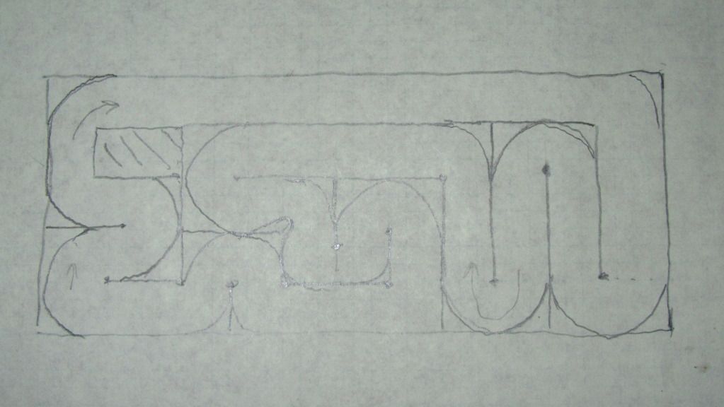

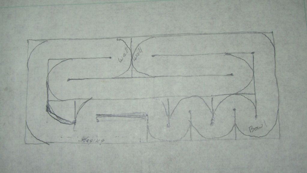

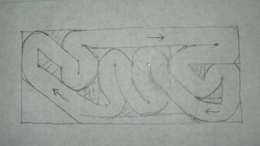

While we're coolin our jets waiting out the weather I started wondering if there has been decisions to what we'll be racing down here. Fathers day is right around the corner and I've been thinking about a 1/10 sc truck. Already have a 1/8 buggy. These seem like reasonable classes to run on a track this size. Along with others too.
Also, the boredom got to me the other day so I sketched out some track layouts. These are no where near as nice as the one Tracy did up a few pages back and I don't want to step on any toes but I couldn't resist the temptation. I based mine on a 140 x 60 foot print so I think it would need to be trimmed back to fit the 130 foot print that Todd stated. I kept the lane width between 10 - 12 feet so fits ROAR specks. I didn't add in features, I figured we can hash that out on site. Personally don't really care to much about track layout I just can't wait to get a track up and running; like I said I was bored.
I've got fairly thick skin so feel free to skewer the track designs I won't take in personally.

Old 06-09-2012, 03:12 PM
  #444
jaredstandiford's Avatar
Join Date: Nov 2011
Location: burien WA
Posts: 169
i like the third on it looks like it could be a fun and challenging track so does the second one but im leaning closer tp the third

Here is a current proposed dwg of the stand...and a noodle of the thrid track in the example post. Jeff, shows double stairs from the side, Kody shows a single stair to the back. Which one please?
Coming off the back of the stair to go around to get your car, when you are alone can become tiresome for the beginners...

Any thought given to building some of the features out of wood, it would make track changes simpler and quicker and require less dirt to be imported. I like layout number one for the average racer/bashers, number 2 could be awesome for advanced guys.
