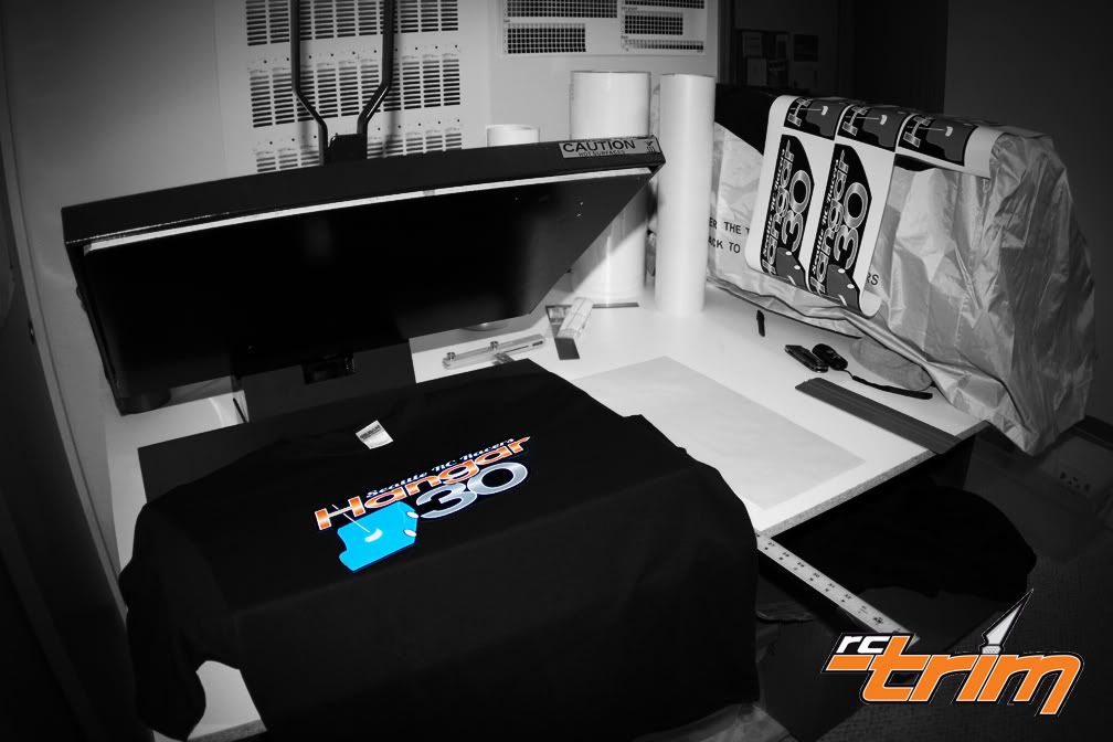

Join Date: Dec 2002
Location: Seattle, WA
Posts: 3,227
Trader Rating: 21 (100%+)
Cool Hard day at the office

Trader Rating: 16 (100%+)
Looking good Pete. Can you make a mean toasted cheese in that thing too? Can't go wrong with black T's.

Posts: 189
Hell yeah pistol pete's panini's in the near future? dang say that 5 times fast!
The shirts are rad pete keep up the good work my man! Dude when is the golf line coming out?
Ritchie- an no you cant have one your not in our panini club damn will power ran out an had to poke. Keep up the entertainment
