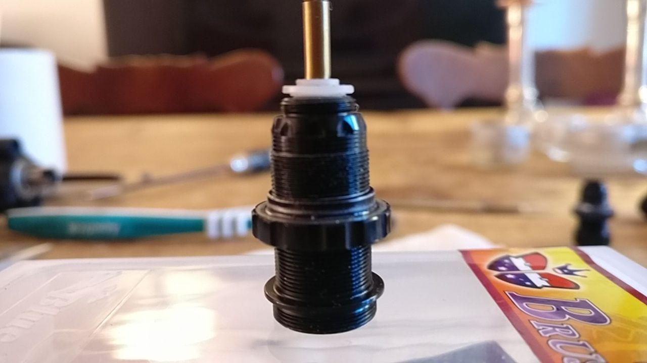

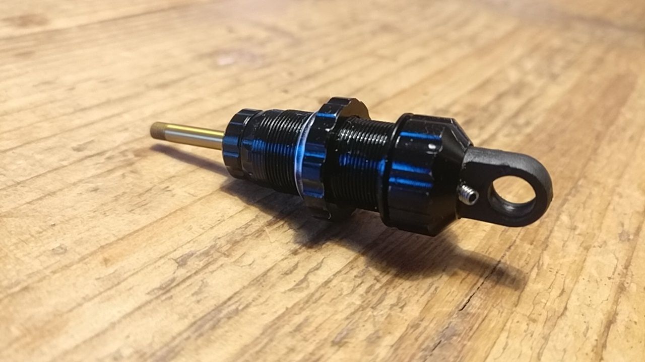

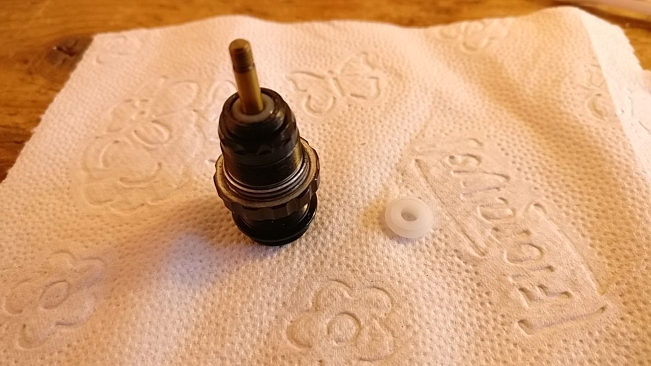

Default Vented shock
Hello there gents,
I rebuilt the shocks with 2 O-rings below using a grinded down washer to lock it up. O-ring grease is from 1up Racing Blue
Furthermore, I drilled a 1.4 mm hole in the cap to allow for a 2 mm stainless steel set screw and no foam. Let's see whether the bladder seal holds up.
