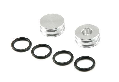

we have updated our floating piston #811304 for our Shepherd Velox cars.
With the help of an additional o-ring the new floating piston completely prevents any possible tilt of the piston inside the shock absorber resulting in a
100% leak-free operation even when using our super-soft floating piston spring #811335 during long race weekends.
The new 2017 floating piston will be include in next batch of car kits.
As a direct replacement the piston is also available separately.
