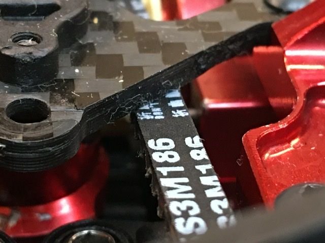

I'm rebuilding a C03 (non-EVO) I bought used recently (haven't run it yet). Has anybody seen this issue? Front drive belt making contact with the radio plate? Standard pulleys installed per the Capricorn manual: 19 tooth mid-pulley, 27 tooth front diff pulley. Something I missed? Thanks!!
Hi
Yes our C03 is the same, not damaged the belt. If you are worried i guess could take edge of inside edge of the radio tray in belt area with dremel.

Bundy_Bear thanks- good to know someone else has seen it too. I figured I'd sand a little of the plate there. Wasn't sure if I missed a shim or something the manual maybe doesn't show.
only thing to check is make sure you have the diff esentric the right way up as opposite front and back.
