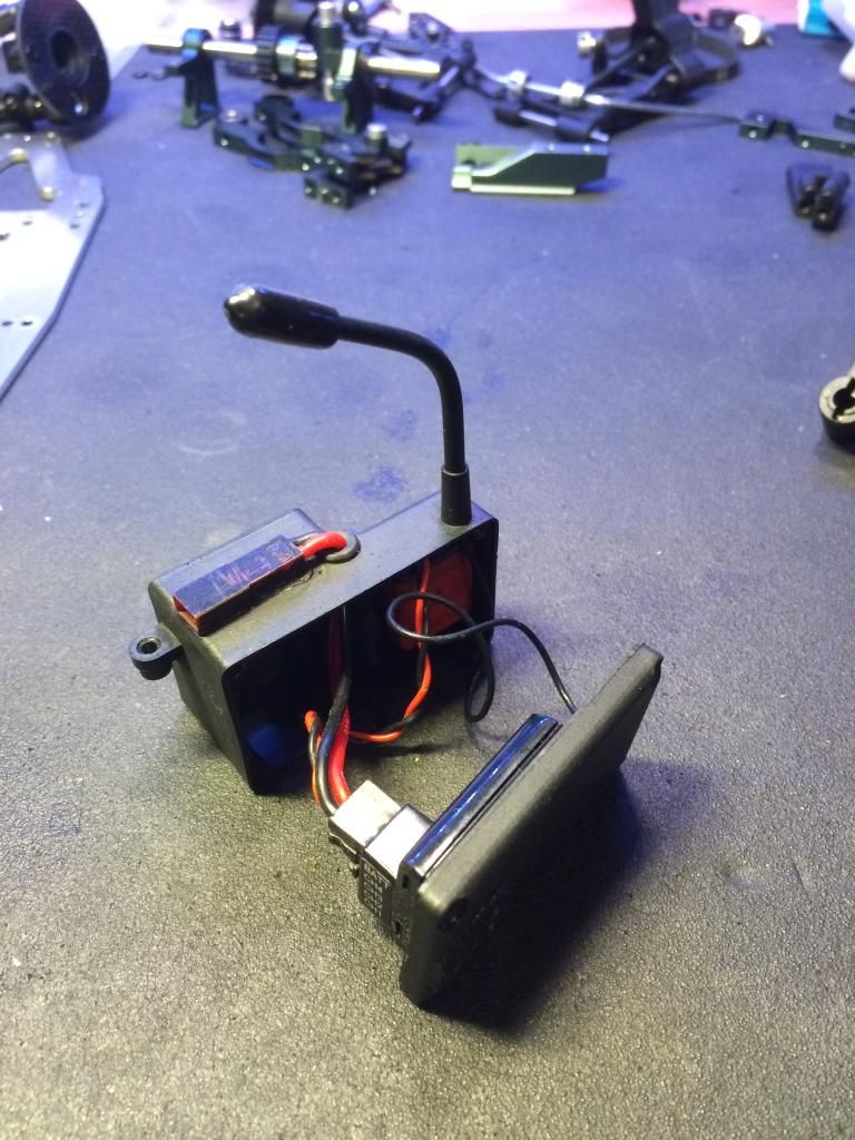

How did you guys wire up your receiver battery?
Hi mate I use mini or micro, dean connectors.
I actually cut the battery pack open and run new longer silicon leads, I rebuild the battery pack re heat heat shrink it.
The neat trick is to mount the recover plug through the body of the radio box and only leave the pin and scocket external.
I borrowed this idea from someone famous...
I will see if I can post a few photos.
I actually cut the battery park open and run new longer silicon leads, I rebuild the battery pack re heat heat shrink it.
+1
Soldered new wiring to the battery, have it exit the battery towards the front of the car and then have it move across underneath the fueltank and run it backwards together with the servo wires.
I drilled a hole in the receiver box and glued the jst connector on top of the box.
For this year I will make a little clip at the backside of the box which holds the battery wire in place when it's not plugged in.
