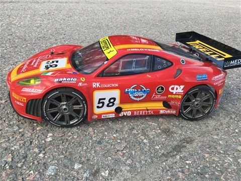

Took her out first time this year, so much fun! Gearbox and new caster blocks really good on parking lot!

Got my 2008 IGT F430 restoration completed with the new (used) body, IGW008 tranny and the all-new caster blocks
looks good!!!
