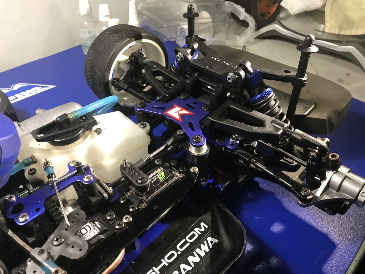

Hi,
just installed the GT3 4deg Caster blocks to my IGT1. They're a direct fit, just use some screws and balls from the MP9.
What I still need is the IGW008 tranny (this was a used car to work on) and waiting for one to arrive in the mail. I'm also using
MP9 universals and some small parts.

New caster blocks made the car feel really good!

Posts: 1,166
what changed?
mustangkillaz is offline
Old 09-15-2019, 11:26 PM
  #1629
MikaR's Avatar
Join Date: Oct 2006
Posts: 1,677
Turning Big time. The tire stays flat all the way. This is how onroad cars should be in the first place, kinda stupid it's an option part
MikaR is offline
Old 09-15-2019, 11:28 PM
  #1630
mustangkillaz's Avatar
Join Date: May 2004
Posts: 1,166
cool. You put it on a rack a get actual caster reading? I'm curious where it ends up.
Old 09-16-2019, 03:20 AM
  #1631
MikaR's Avatar
Join Date: Oct 2006
Posts: 1,677
Sorry I don't have one. But it looks like it's close to zero (flat) i.e. it's that 4deg as it suggests. Anyone knows?

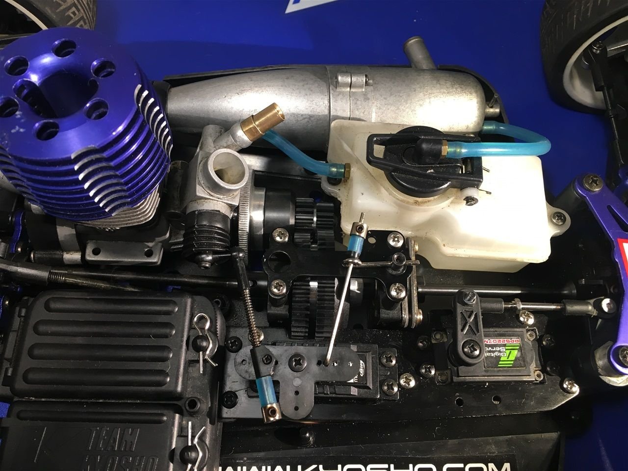

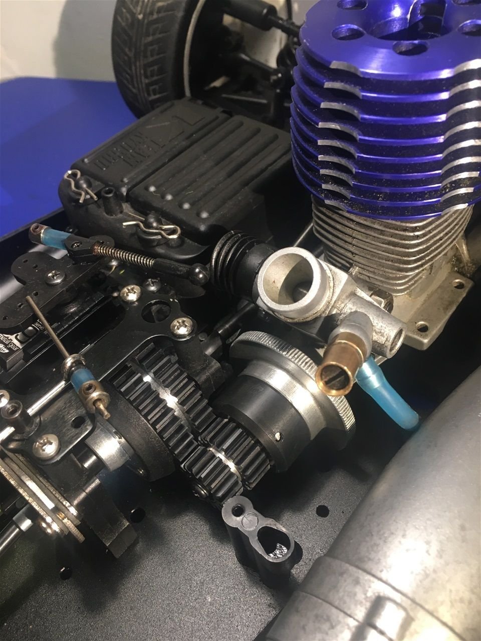

Finally got the IGW008 tranny so now the IGT1 rebuild is complete. Tested and works! Ready for season start in May/June 2020
