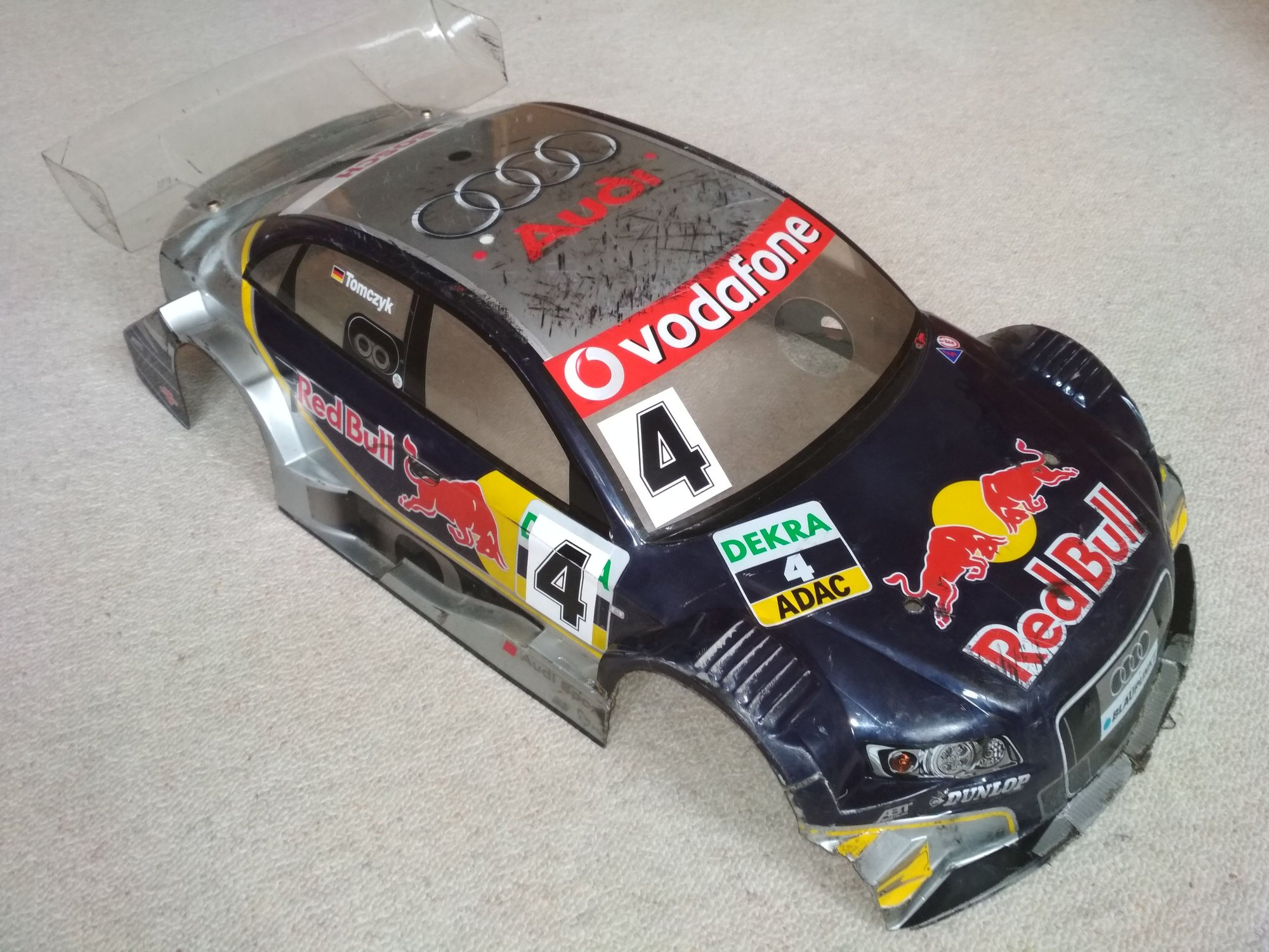

Hi Mike,
Nice to have another kyosho gt2 driver
i think it's better to sell the GT2 and get a Inferno ST-R, if possible. The early Inferno ST-R comes with a lot of good parts, for example better chassis plate, mp777 steering with better servo-saver and much more. Will save you a lot of money, believe me... I have build a race-ready/prooven modified electric GT2, raced it two times and it's stable and performs quite good, but since it was my first time on track, the nice Audi A4 body now has gotten some damage
Good upgrades to start with are the universals, if125 or better hardened mp9 tki/ mp777 ones four all 4 corners, for the middle-rear you can get igw058, but you have to use some shims, it's a tad to short. My next body is the protoform corvette. Here is a pic of the chassis and the used Audi A4 body
where and in which racing-series do you plan to take part? My nitro Gt2 is still not build yet...
