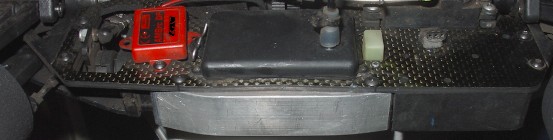

ohh yeah, mistakes happen for sure. It's equipment loss / damages ones I don't like (but still try to laugh).
My second carbon deck in almost 2 years has been damaged at the receiver box area due to T-Bone so the buggy basher has came out in me to produce.....
Very much an overkill.. might remove some alloy from it one day.
au_Nightmare is offline
