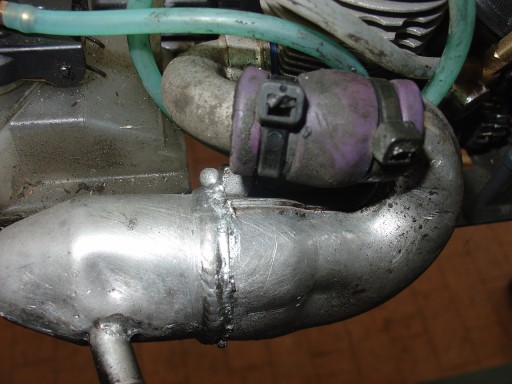

Its the one like DTMS champion edition. I also am saving the $$ for different pipe, just got to find out what pipe and good place to buy from.
Iv'e read in multiple places pipe is too long (engine not rev unless too lean)
EDIT (few hrs later): just took 14mm out of pipe and a bit out of header. Can notice the difference ni rev's. Have to get a new pipe for sure.

That hong-nor one is the same as my 2 "spares" and have same problem I believe.
hmm I'll PM you in a re: THS pipe
Here is a photo of what I done, I cut the pipe with hacksaw near weld and near pressure connector then "welded" the pipe back together.
Also cut a little from header to get pipe to sit back in same place.

that is what the THS pipe looks like but its in line.. my mistake, dtm's champions pipe is not like mine.. hehe! my bad.. but there is a problem with my pipe still. i saw the receipts from my purchase and found out the pipe is JPL. sorry for the confusion. you got pm nightmare!

You need a new pipe
