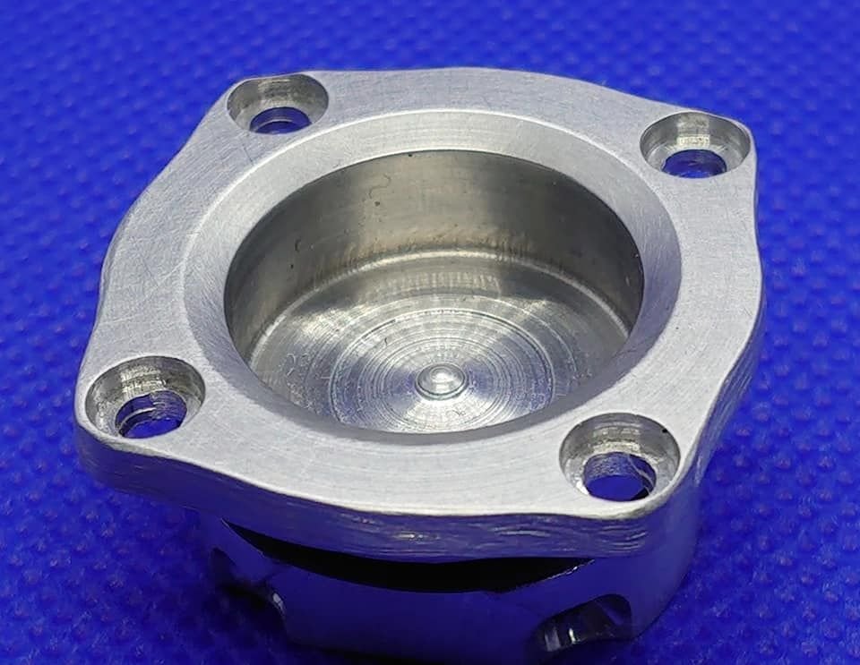

Default EB Mods PP-1 Back plate for O.S. Speed Engines?
Hi,
I bought one of these a long time ago. Has anyone had experience with it?
Thoughts much appreciated.
Cheers,
Mac

Funny thing is that XRD has introduced a motor which has sadard such a backplate.
This week I was modding 2 engines for a guy who likes modified engines and all kind of special stuff, I haven't touched my machines for a while so I thought to make such a backplate for that guy his Picco Boost, I must say for a 1st attempt these backplates ar easy to make....

nice work man. These must be for nitro mike, hes got a nice following on your tube, nice kid with good vids and speaks super, super highly of your work. Good stuff!
