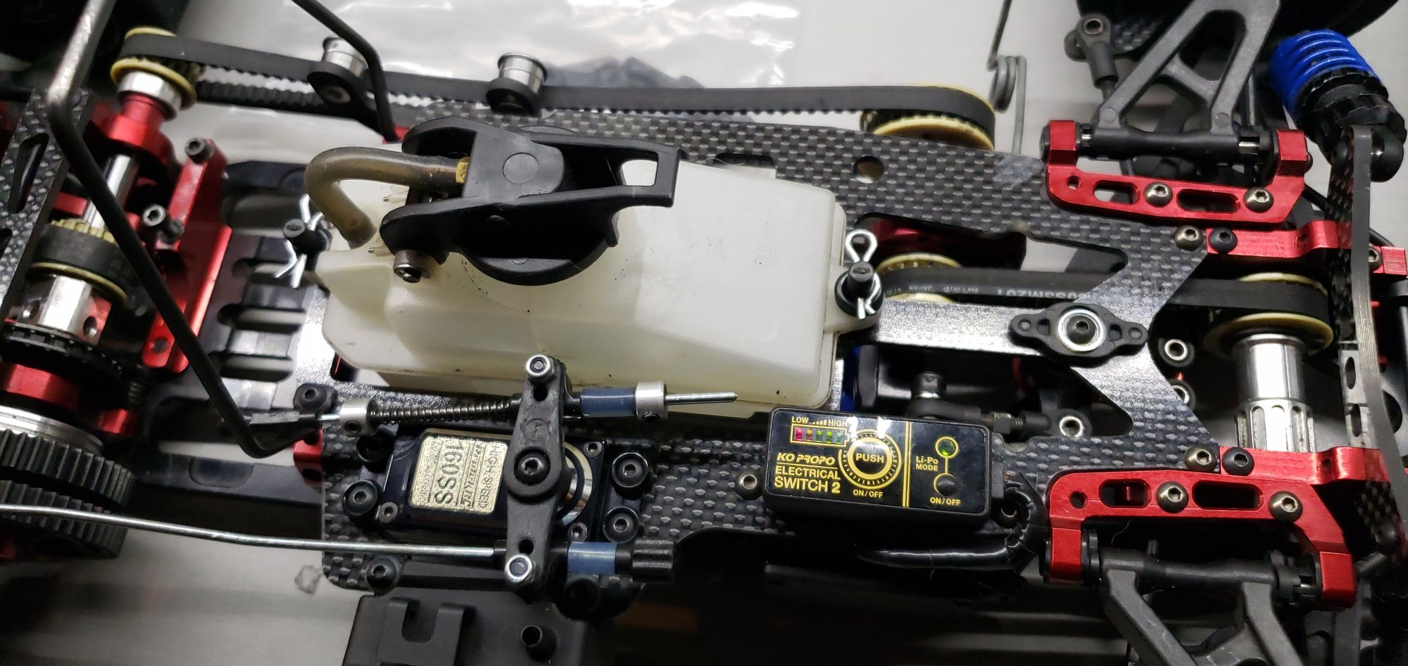

Just installed this one on throttle. It's on the weaker side, but should do well.
