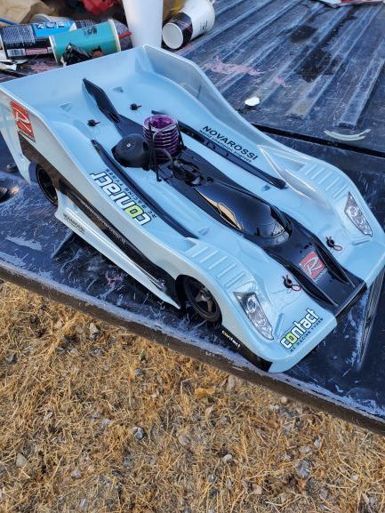

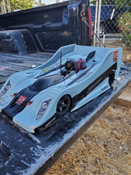

Ready for the track tomorrow
BigC2007 is offline
