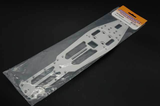

ARROWMAX 750 Chassis Arrowspace Mg

I've seen this chassis on RedRC. Gotta wear out my current chassis before considering this. Even then, not sure I want to give up the weight as far as CoG goes. Thoughts??

Same here... In stock form my 750 is only 22 grams over the legal limit with 1 25 gram weight installed. Too much weight removed too low in the car....
