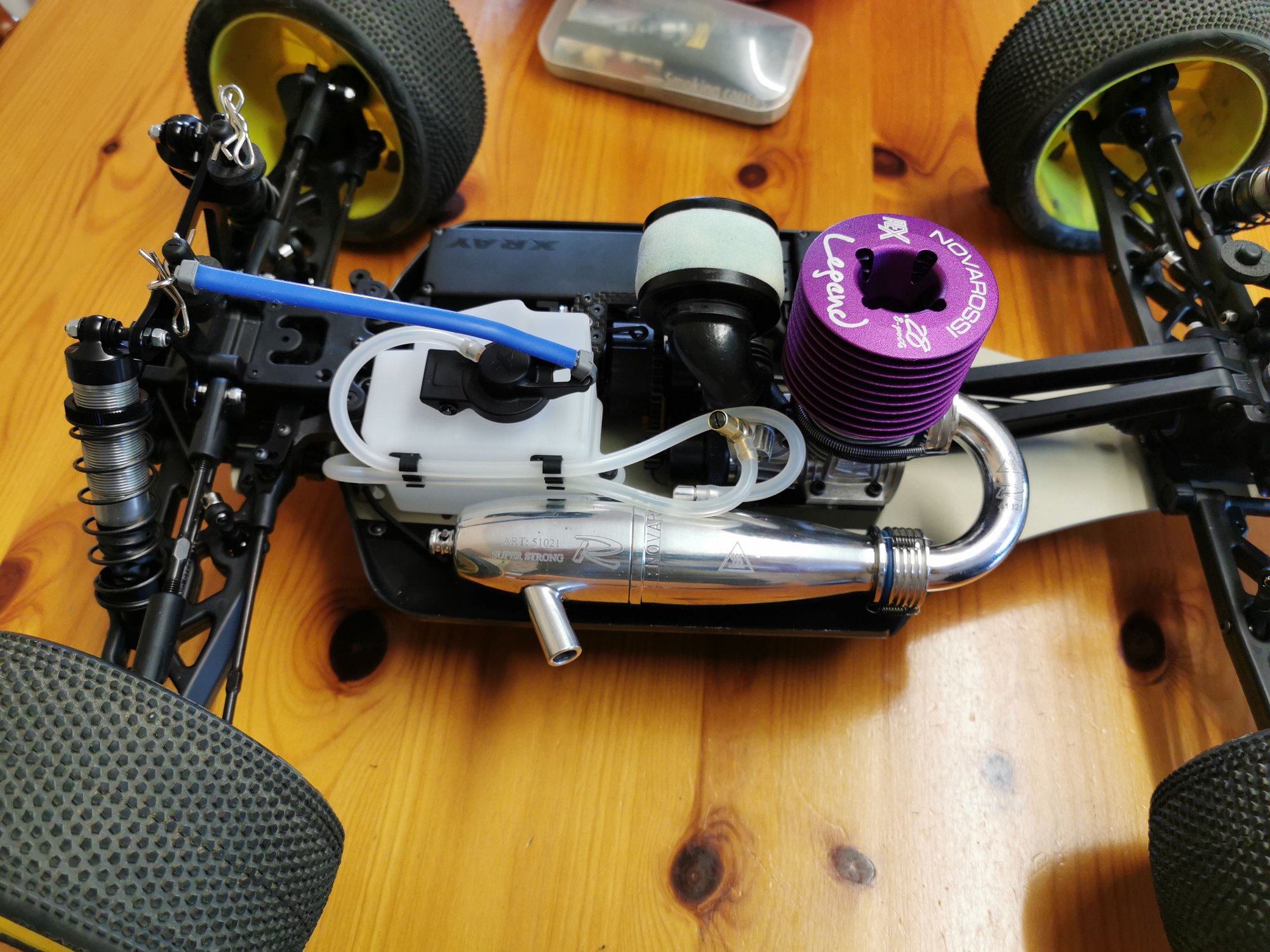

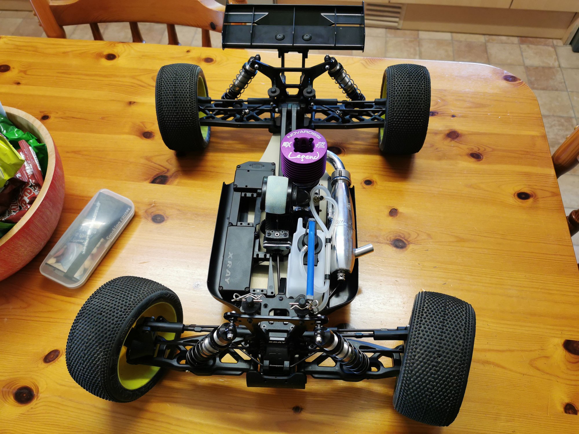

So whilst installing a nice shiny Novarossi 28 8, I decided to install the graphite top plate.
The Xray flywheel sits slightly too far forward on the cone supplied with the Legend 28 8. I'm hoping I can fettle the cone (without knackering it!) till the flywheel/clutch assembly fits with adequate for the clutch bell. At the moment, the clutch bell is too close to the end of the crank, but I'm sure there's a work around. I'll keep re-fitting the flywheel (using the flywheel puller for removal) and torque the nut right down each time. If that doesn't work, I'll have to grind the cone or buy a different one.

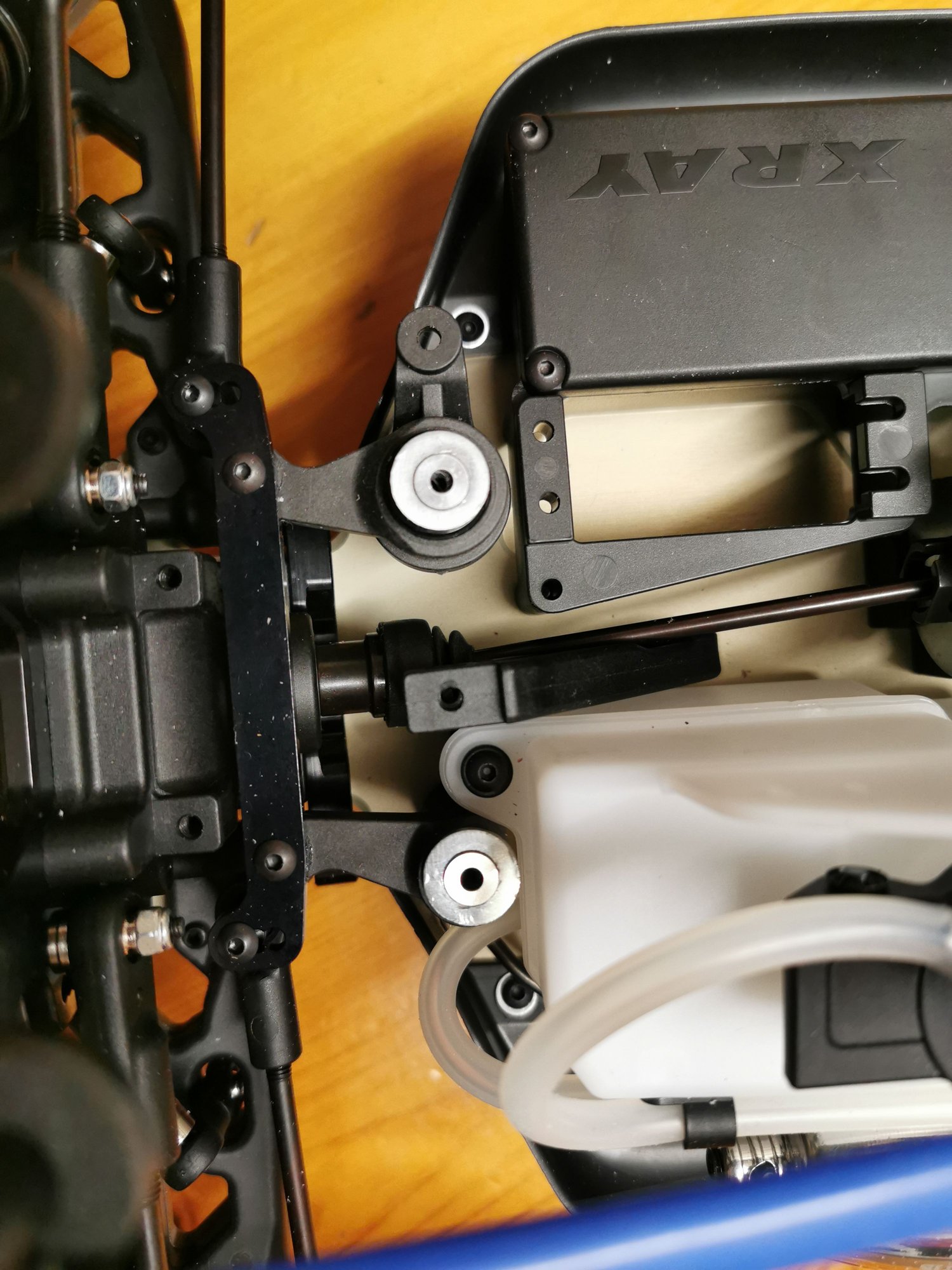

Now the graphite steering top plate fits with 2 alloy shims, according to the note in the manual. Except that it doesn't! The servo saver and steering link assembly had waaay to much up/down slop with just the 2 small shims, so I needed 2 larger diameter - and thicker - shims to go around the little ones.

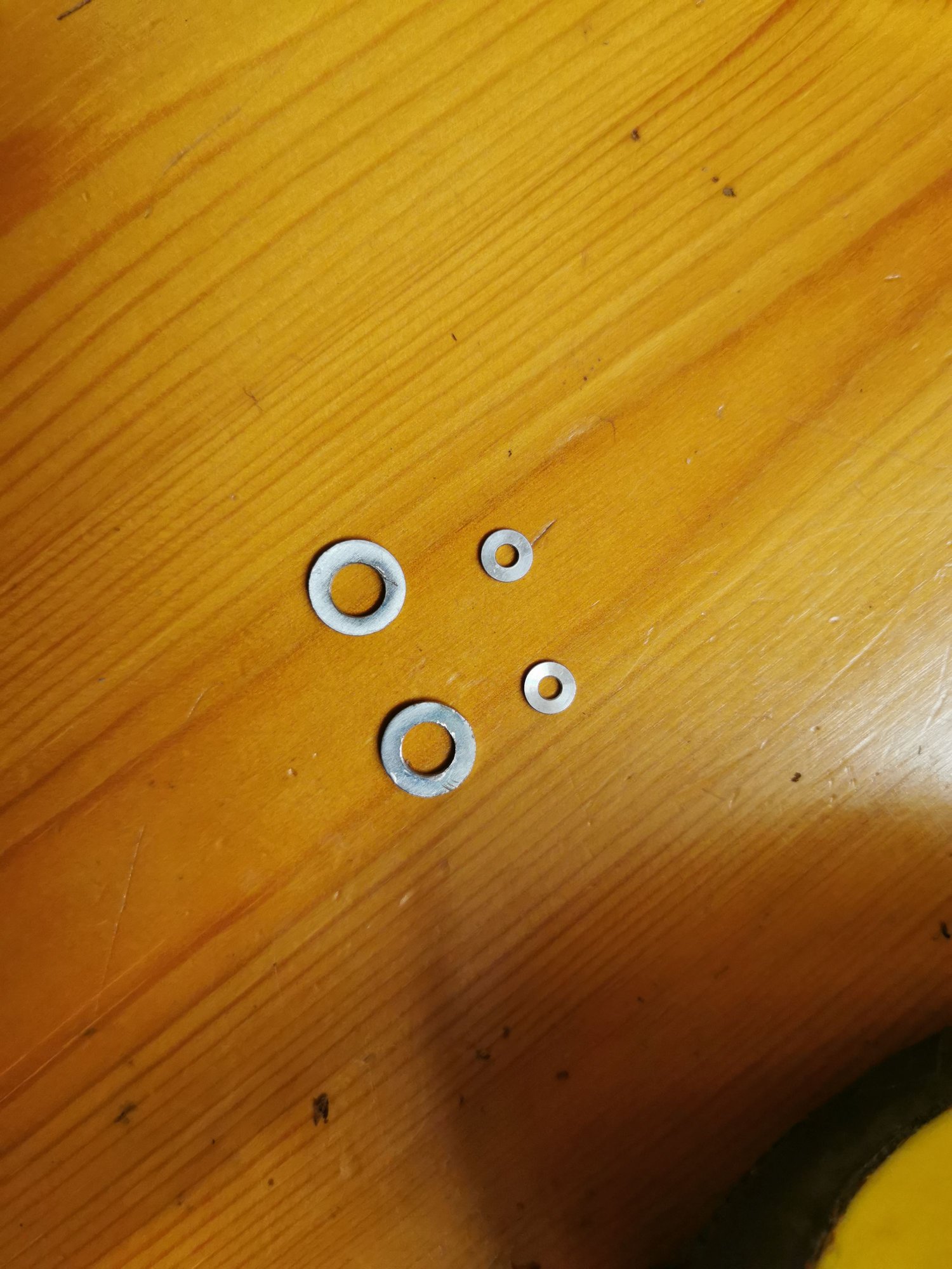

2 little shims on right, along with the bigger shims that needed to be drilled out to fit.
Plan view of steering posts with shims fitted.

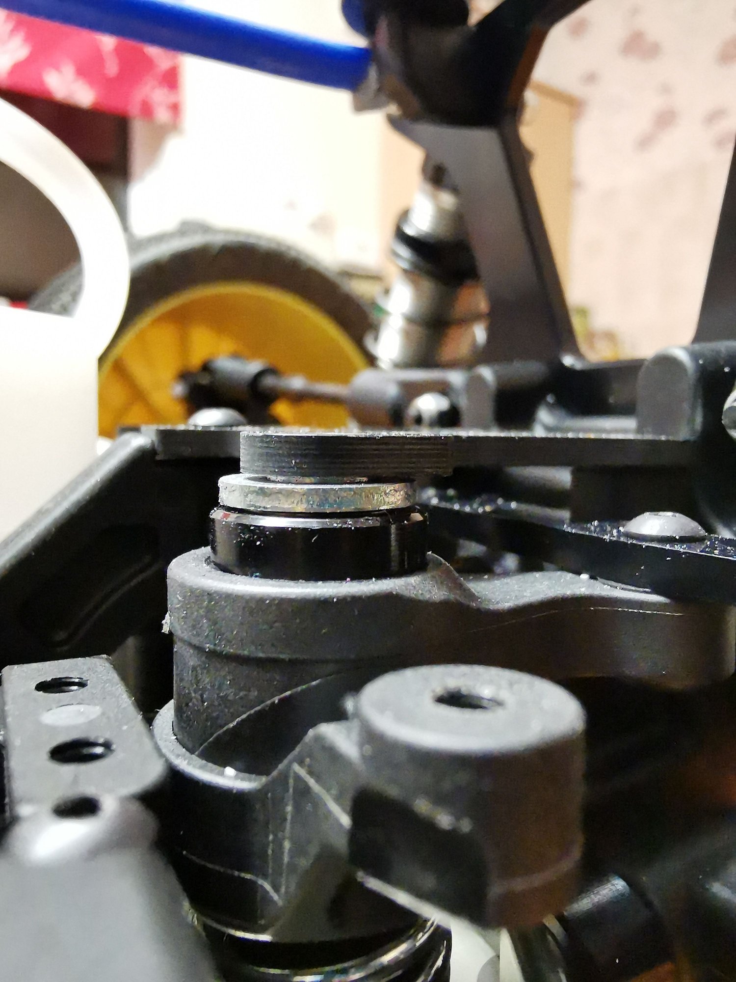

Macro shot of the top of the post with graphite plate fitted. Plastic shavings are from the body, recently trimmed for the 28 8.
​​​​​​The graphite plate fits fine, provided shims are used beneath the small ones outlined in the manual. This is 100% essential, otherwise the steering posts can move up and down by approximately 1 yard! Further more, I could find no reference to any spacers or washers to take up the slack. On the standard composite item, the correct spacing is perfectly moulded in.
The washers I used needed to be drilled out to about 6.5mm, to fit the small shims.
