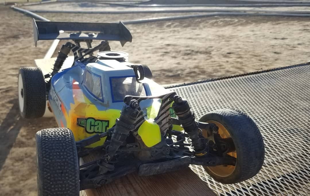

got in some nitro racing action this past weekend. Had a good time. Looking to do some tuning, biggest thing is a bit better planted rear end as when attempting to square up it would get loose at times and a bit better jump handling.
Also, the car seems to get a lot of toe out on longer droop levels .
Conditions are very loose, where older style AKA tires work well (impacts, etc). So any tips relative that would be good.

on the rear tower lay the shocks all the way in. Try a 2.5 or 2.4 rear Swaybar. Also run rear hubs with insert hole up 0. If you can give me a setup sheet I can make more suggestions of changes.

ounds good. I'll get one posted this week.
Need to hunt down some swaybars here.
