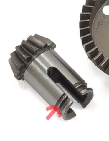

Has anyone had a problem with the diffs eating bearings? A local racer keeps losing diffs because the shield falls out of the bearing and gets mashed into the ring and pinion. Is this a common issue or is it more than likely a builder error?
Sounds like a build or shim error. never had a diff bearing fail.........
The diff has 2 outdrive bearings and 2 pinion bearings. which are failing?
Also are they stock bearings or aftermarket?
given proper shimming... the pinion's diameter would make it impossible for a bearing sheild to make it over the pinion and impact the crown gear...
if the snap ring is not installed correctly and falls off the play could certainly destroy the bearing and the pinion and cron gears along with it...
careful shimming and making sure the pinion retainer ring is properly installed is a must.
interesting in that I have never had a driveline failure in my HB cars - going back to the D8.
as with any car careful setup and proper parts tolerance goes a long way to maintaining durability...

Thank you for the reply’s. The bearing that keeps failing is the inside pinion bearing. I’m leaning towards the possibility of the snap ring being improperly installed as the cause of the failures. That inside bearing is huge and seems indestructible so I was perplexed at how it could keep failing.
Thank you for the replyís. The bearing that keeps failing is the inside pinion bearing. Iím leaning towards the possibility of the snap ring being improperly installed as the cause of the failures. That inside bearing is huge and seems indestructible so I was perplexed at how it could keep failing.
make sure the snap ring is on the smaller 2nd groove like in the picture.
a worn ring will pop off onto the larger groove.
twigstoy likes this.

I’ll check with my buddy and see if that’s where he had it. When I was building mine that double groove messed me up for a second until I felt how loose the pinion was and knew something wasn’t correct. This car is leaps and bounds better than the Associated that I’m coming from. I can’t wait to get it dialed and see how much better it is.
