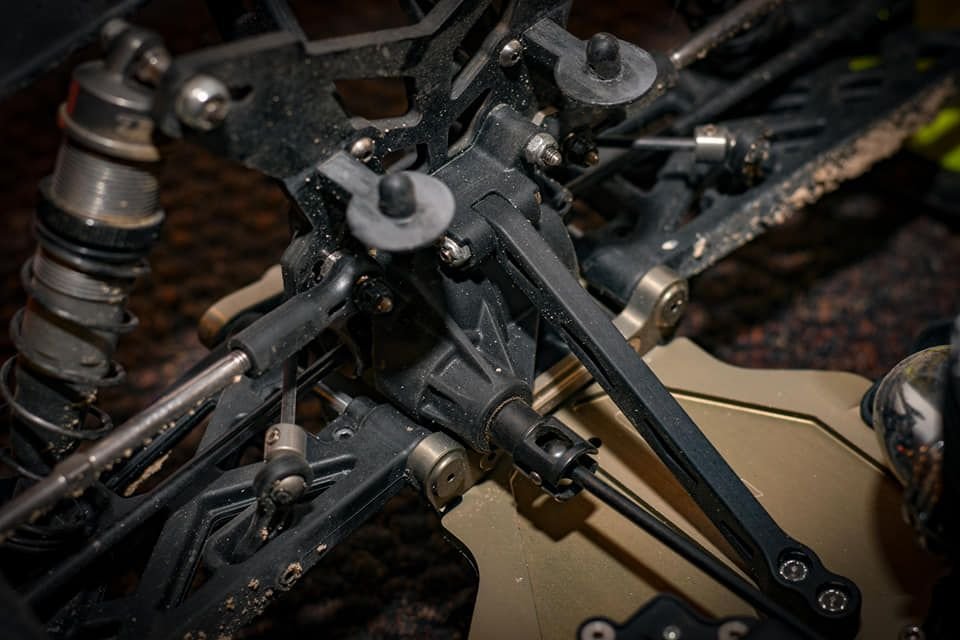

Dakotah is running a 8T 4.0 with the 8X rear hub on it. You have to then also use the 8X rod ends with th e4.0 turnbuckle to make it long enough. You put the axle in the hub, then 1.5mm of axles shims, then a +2mm hex.

I just did the conversion and I used the truggy turnbuckles.
8x hubs, 8 x rod ends. You just have to rheam the hole a little to get the rod to start threading into the plastic.
