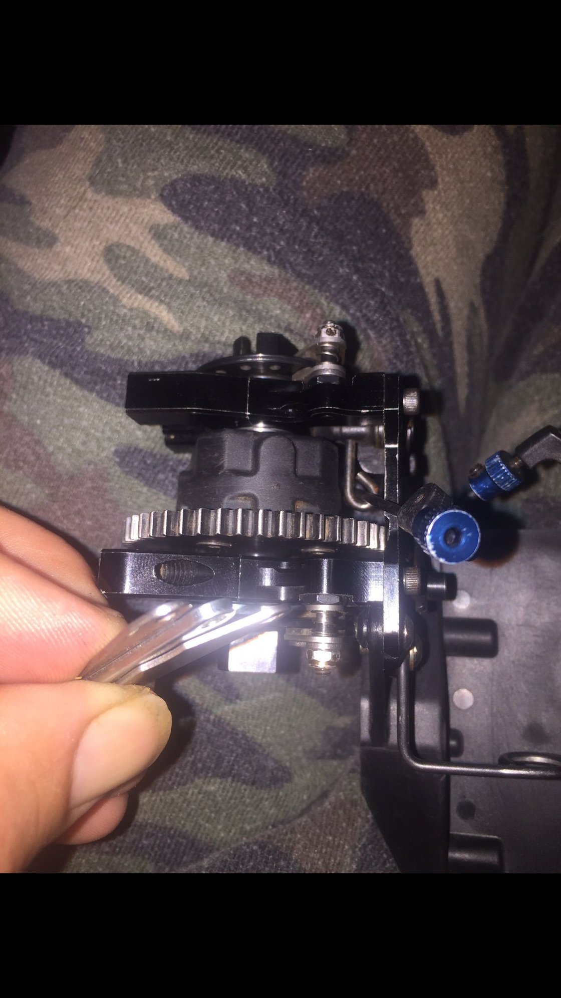

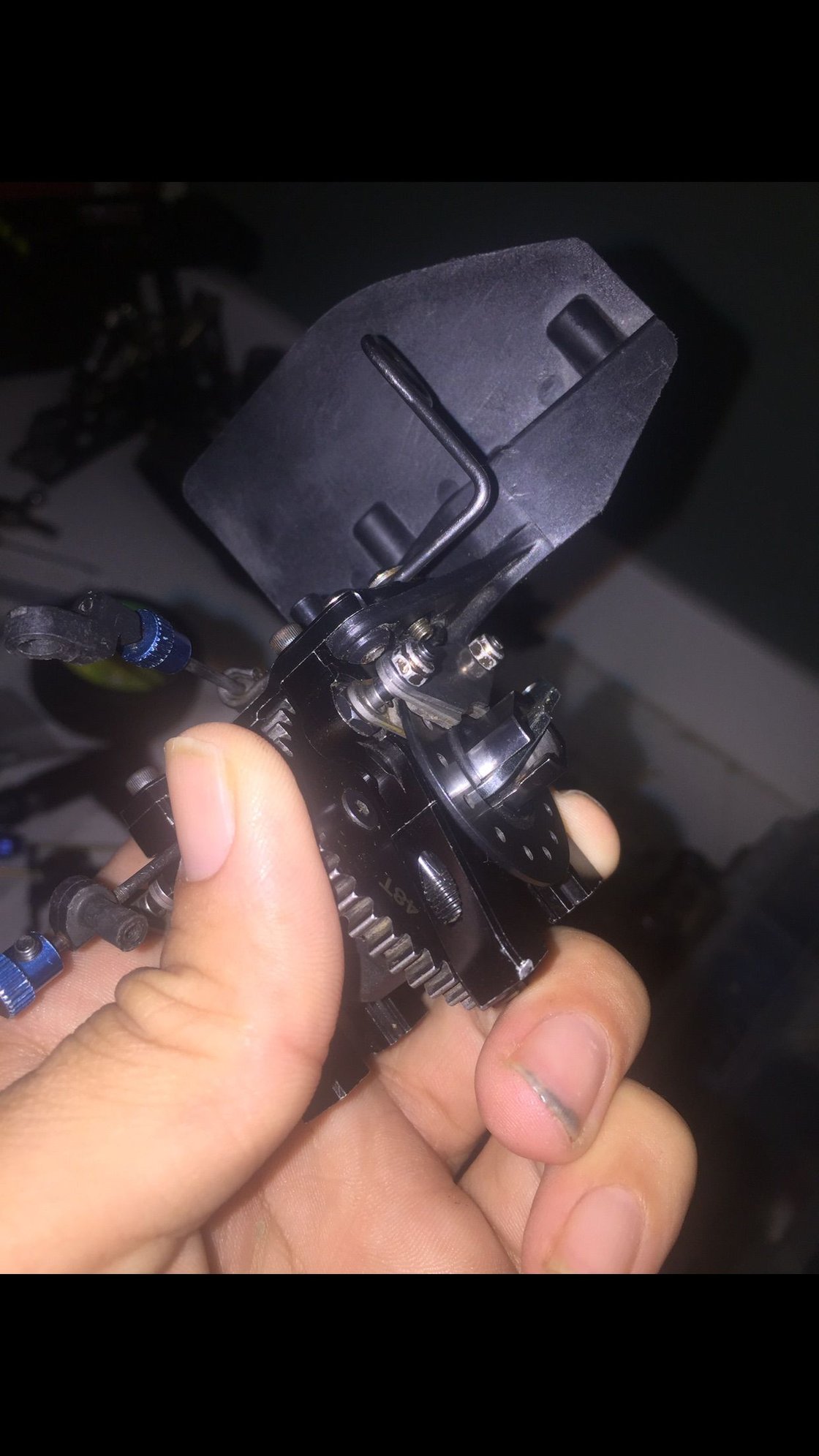

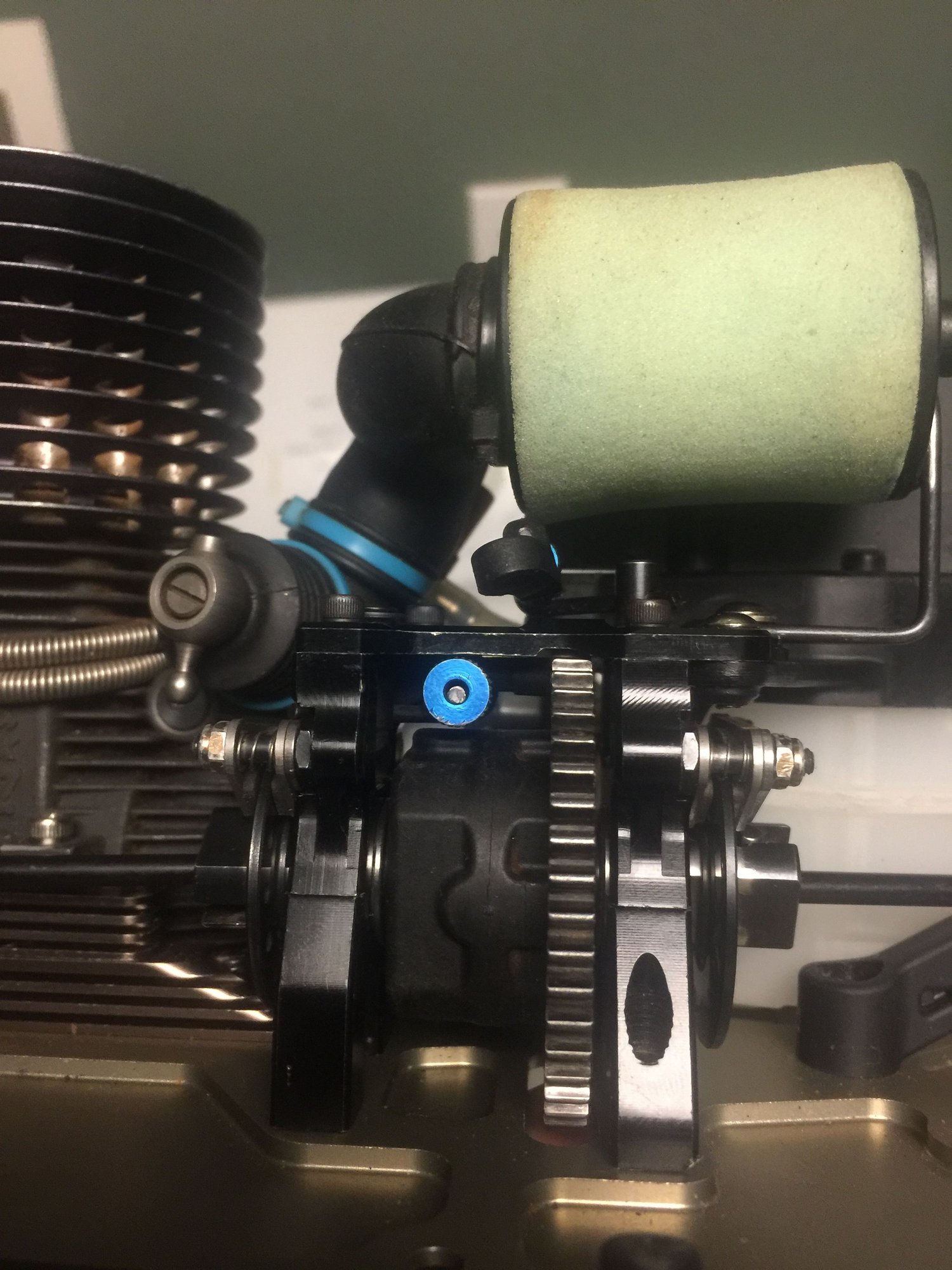

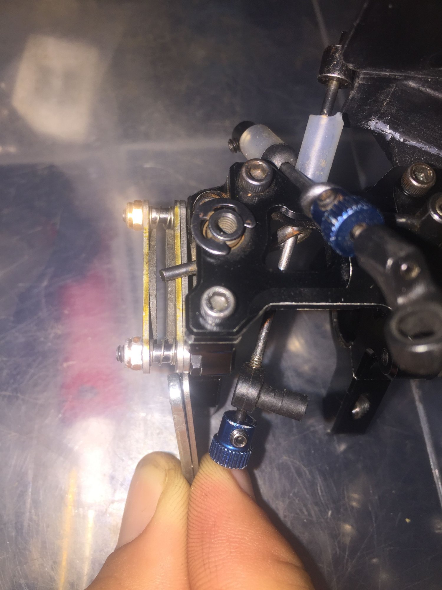

het guys I was able to get these to work but wanted to show u have to work around a few problems you will run into using this set up. Personally I know itís going to rock because itís going to be rock solid. I however do have a few of my own questions.
First off you wonít be able to use the tuning kit breaks without a few things I was lucky enough to still have laying around, the new pads actually need super old Ďthiní pads from I believe the 1.0 days as spacers, the pads you will be replacing are similar but about 3 times the thickness as the old 1.0 pads, however if u donít use them in the correct spots the brakes just donít work because both sides have different issues, the rear brake you have to put the pad as a spacer between the point of contact with the cam and break, and on the front you have to use the pad as a spacer on the far side where the nuts hold on, both pads used as spacers make the pads and rotor have the perfect spacing, on the rear brake you use it behind the pads so the cam pushes on it, reason is if u donít use it as a spacer there the actual inside pad will center completely off angle due to the shape of the new rear pads being nothing like the regulars brakes, they have a shape more like the bigger lower hanging front brakes and these aluminum diff mounts are milled for the brakes to be small like the standard rear ones are.

One of the problems I’ve had (not just with it on the 4.0) is the aluminum center diff mount kinda affects how smooth my drivetrain spins. After knowing this awhile I stopped using these and saved this newer one for when I could figure out how to use it affectively. So i spent half hour testing it against the stock plastic set up with the brakes taken off of just the plastic stock set up and kept switching back and fourth my whole center diff and it still does affect how free it spins and I don’t know why. The only way I can get it to spin just as free is if I loosen the top screws a hair and even the bottom and the drivetrain comes back to life. Is there anything that u guys can think of? Maybe lock tite in the threads need to be acetoned out? Or somethings not tightening down correctly and causing bind?

I used the upgraded brakes and pads without issue on my aluminum center diff mount. I left out the springs, and i used flat washers behind the nyloc nut instead of another brake pad. Required a little tuning to get the cam to engage the back of the inside pads, but overall it wasn't bad.
my drivetrain did not spin freely at first, but after a few tanks of fuel through the engine and actual load on the drivetrain, it now spins like butter.

I was thinking maybe it just needed a break in period to get everything to settle in. I will try that. Behind the rear pads tho I def needed that this pad so the cam presses the brakes on correctly. Shins would work up front but on the rears I wasn’t sure and knew the thin pad I had would space it perfect and allow me to set it up somewhat normal so that’s why I used what I have on it. I know I’m gonna love it but I know the aluminum center diff mounts really make everything solid in the center and the clutchbell really takes that hit and chews up gears faster. I also know it made the diff cup get notches from the extra load on the pins inside which start making grooves that cause the notchy feel so I’m going to buy a few extra cups to keep everything fresh and rebuilt when the center diff gets hot after long motos.
