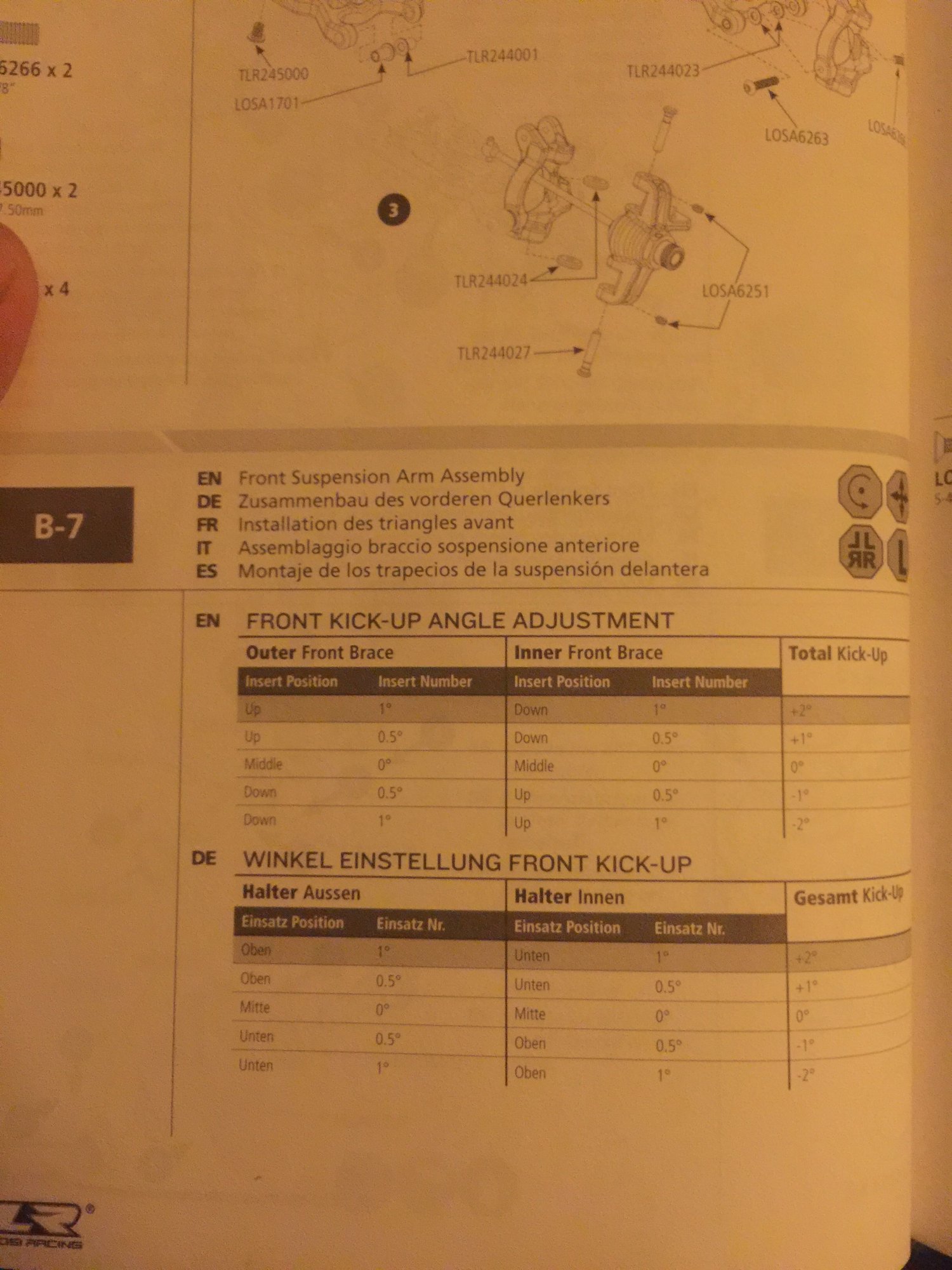

Hey guys Iím looking for some advice on what # inserts (pills) to put in my A/B/C/D blocks to try!! Iím really looking forward to testing something new!! If possible (so itís a little easier for me to understand) could you just say what pill # to use in what direction in each block, Iím still not totally sure how to understand what # pills equate to specific kickup or castor when reading the manual. I believe right now Iím using pretty much pill #0 in my A&B blocks and the C/D blocks I know I may have the same but Iím not totally sure I just know they are wrong and Iím driving on a pretty dry and dusty high speed track with big jumps!! We do water in mornings and I have 2 4.0 buggies I drive each day, one for dry and one for wet! Any advice for these specific conditions would be awesome and I absolutely will try it out with much appreciation!!
Best set up is Phends last set up for that car. The pill information can be found in the manual.

ok sounds good, Iím pretty sure I gel with his style of driving aggressive and could figure it out. Itís about time I understand the pill direction and what(front kick up and rear toe) they equate to anyways so I can put these in right. I was actually looking at my cars and they do have set ups that are correct I just donít know what degree they come out to. Once I figure it out Iíll know what fronts and rears to use for what I want changed.
is this Vegas worlds the set up your talk
ng about? I wonder how much different that car is from my 4.0
*Well friggin A Iím gonna have to look it up online. Just Incase itís helpful this is everything they have in the book which is helpful just doesnít go into depth. I left out the stock set up sheet.
https://www.hudy.net/xhudy/products/...4527a27dcf07e4
Here you go.
