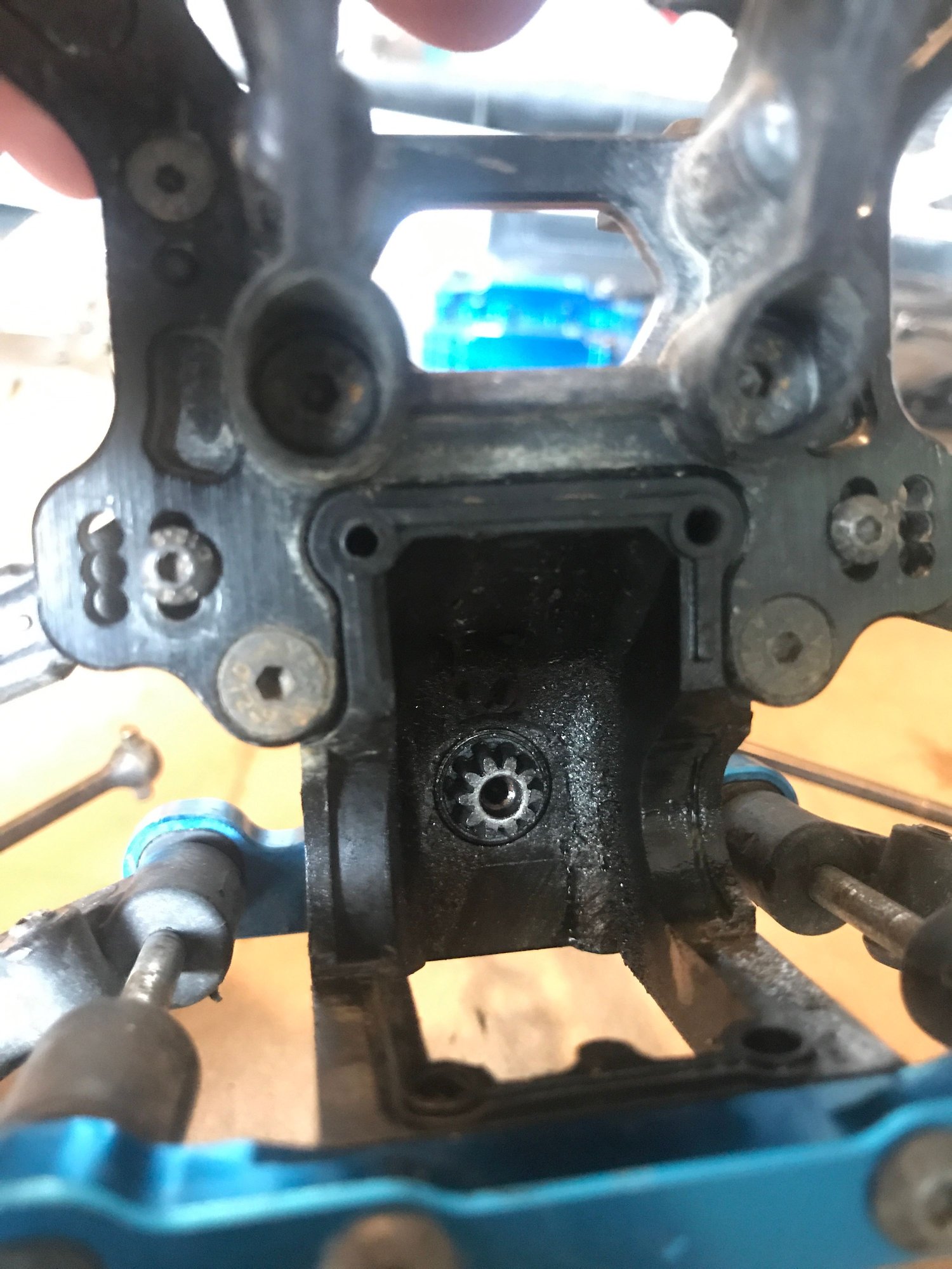

A noise started happening on my rc8t3.1 that sounded like something in the rear diff slipping and I took the diff out and the diff itself seems fine, bearings could be replaced, but not the issue. Could it be the pinion slipping on the ring gear and in need of a new pinion? Lots of metal shavings in that area but I doubt it came from the ring gear.

Check pinion and ring gear, I would replace pinion.
Then try shimming like this.
Make sure its very snug, almost to tight. Run a pack or tank and recheck.
