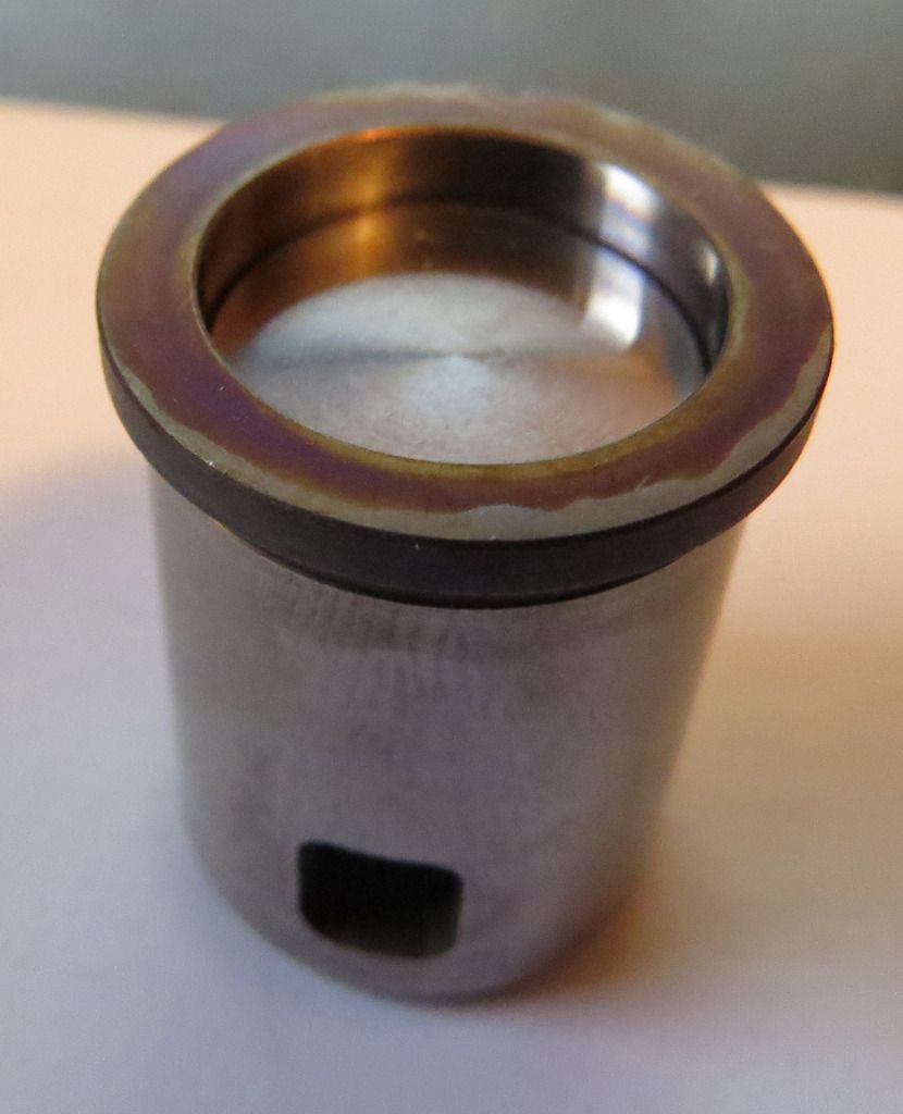

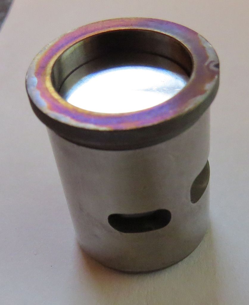

Is this good pinch for a new OS Max .15CV-X sleeve?
I was expecting more. and why is it purple on top, is that normal?

Kind of hard to tell if a pinch is good from looking at the piston in the sleeve. Best way to tell, is to install it in the motor and turn it over by hand. One of 3 things is going to happen. 1. Its too loose and you can turn it over easily by hand. 2. Its tight. You can turn it by hand but there is a good seal and a slight mechanical pinch at top dead center ( that's what you want). 3. Its very tight and you cant turn it over by hand ( how a engine comes from the factory).
The discoloration look is somewhat normal. Just heat discoloring the brass of the sleeve. Being it is uniform all around the sleeve, means it was running ok. If you had it only on one half, something was off. Don't worry too much about that.

thank you, is that test with the glow plug in? Also I didn't install it yet, thats right out of the package. Are they purple brand new? trying to find out if i'm getting punkd

First question, who did the work? If it was anybody other than RayA racing then there could a lot of problems. Most are things that require pretty expensive and percision measuring tools to check for. Ray has done tons of these for people and most of the others who have a good rep use Rays tooling.
You got two choices, put it in and run it or send it to Ray and have him try and fix it if it was done wrong.

I think I could have worded my op better. The sleeve and piston are brand new OEM OS engine parts. It came to me like this, I never installed it. It just seems like the piston comes up farther in the sleeve than I thought it would, being brand new. I just wanted to make sure I'm not getting punkd by someone who re pinched a sleeve and is selling it as new.

no
engine needs to be completely assembled.
and many time an engine will have mechanical pinch when cold
but loose it when it heats up.
If you put it on the track and it runs 3 to 5 minutes and shut off or feels
like it is losing power at the end of the run, then it needs a pinch.

CV series engines never really had that much pinch to begin with.
