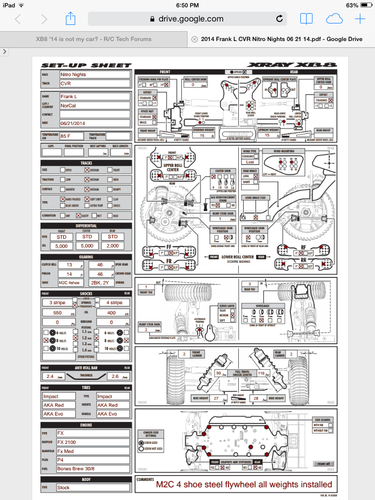

Old 06-28-2014, 07:45 PM
Tech Lord
iTrader: (148)
Frank L's Avatar
Join Date: Dec 2008
Location: NorCal
Posts: 12,522
Trader Rating: 148 (100%+)
Heres what I am running. Its very close to Tyler Vik's DNC setup
https://drive.google.com/file/d/0B2R...it?usp=sharing
