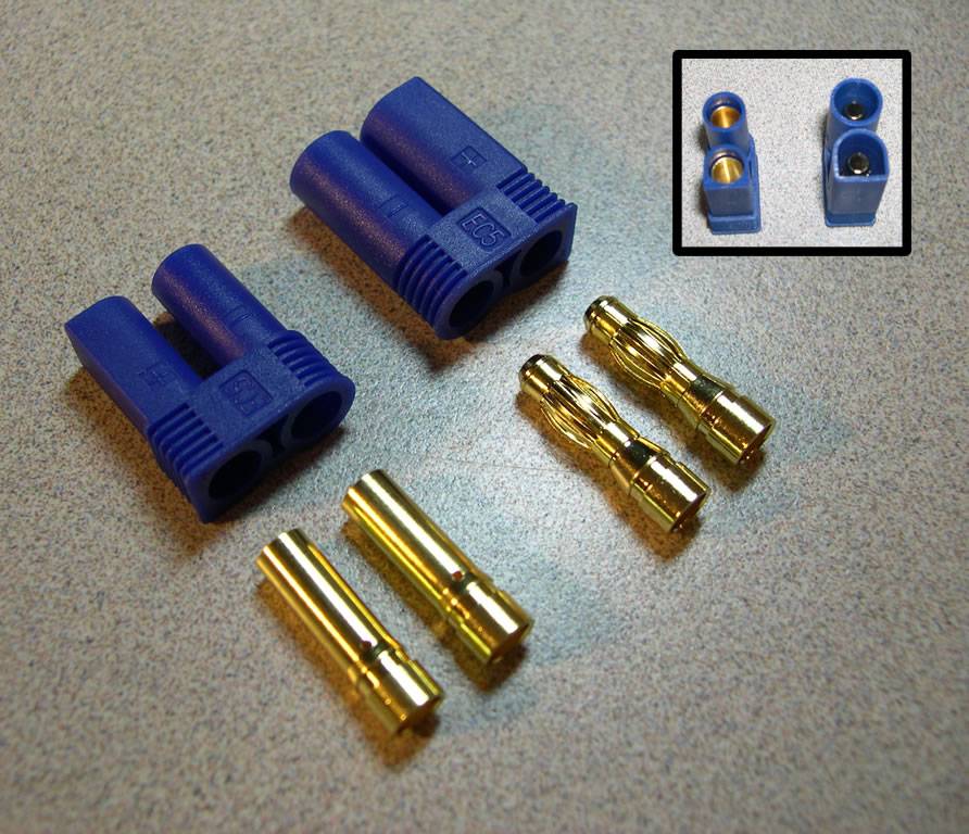

if you change your connectors there is much better than deans:
EC5 (LOSI)
people should stop using deans, they weren't designed for 1/8
Pulse_ is offline
EC5 (LOSI)
I've had, and seen, more failures due to those "birdcage" style bullets than I can remember. Castle bullets are way better....
Honestly, the trusty 'ole Traxxas connector is the way to go. I run them on all my electric devices....inexpensive, handles high current no problem, and just about every hobby shop under the sun keeps them in stock.
EC5 (LOSI)
Don't use the birdcage bullet as seen in the picture. They tend to melt. Instead use a solid bullet and these connectors are good.

Originally Posted by JsK View Post
Funny thing is there always seems to be a "better" connector than Deans. Seen
a lot of them come and go over the years and where still using Deans.
I agree !!
Ive been using these for year, never had a issue. All my connections use EC5's. You need a good iron thou if you don't have one these can be challenging. You need to be quick with a good station for holding the connector so your able to make a good connection. They stay put without any disconnection issues.
