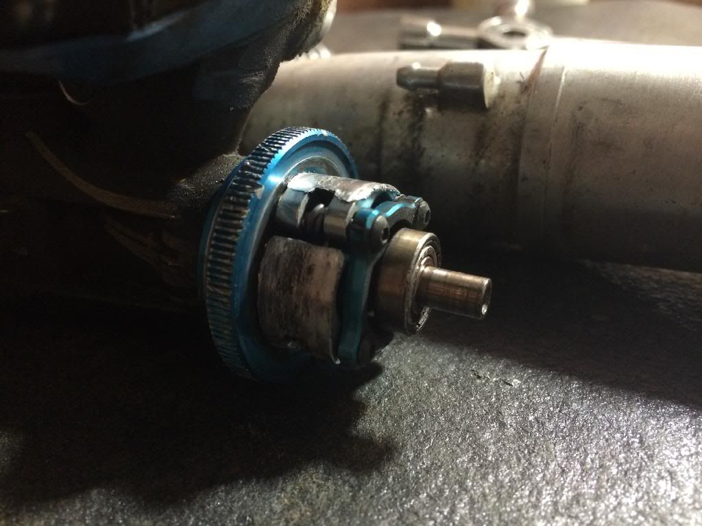

Opened it, and the problem popped up right away. The outer bearings were completely destroyed, the little balls were everywhere. How could this have happened? Also, should i change my clutch shoes while i'm at it? I have a set of new ones just laying around.

how that could have happened? 1- shimmed clutch bell to tightly 2-cheap bearings 3-engine mount at a angle...losi has lines on their chassis use them. and trash them shoes! lol

You have tons of life left in those shoes.
Chuck them in the trash, put new ones in with new springs and new bearings.
Scuff up the bell with some fine grit and you will be good to go.

Don't forget #4: Bearings aren't "set them and forget them" items. They have a lifespan. You should replace them when needed.

Usually change ours before a long main and then again before the next race day. Especially if you are running the cheaper bearings.

That inside bearing doesn't look 2 practices old. Almost looks as old as those shoes.
