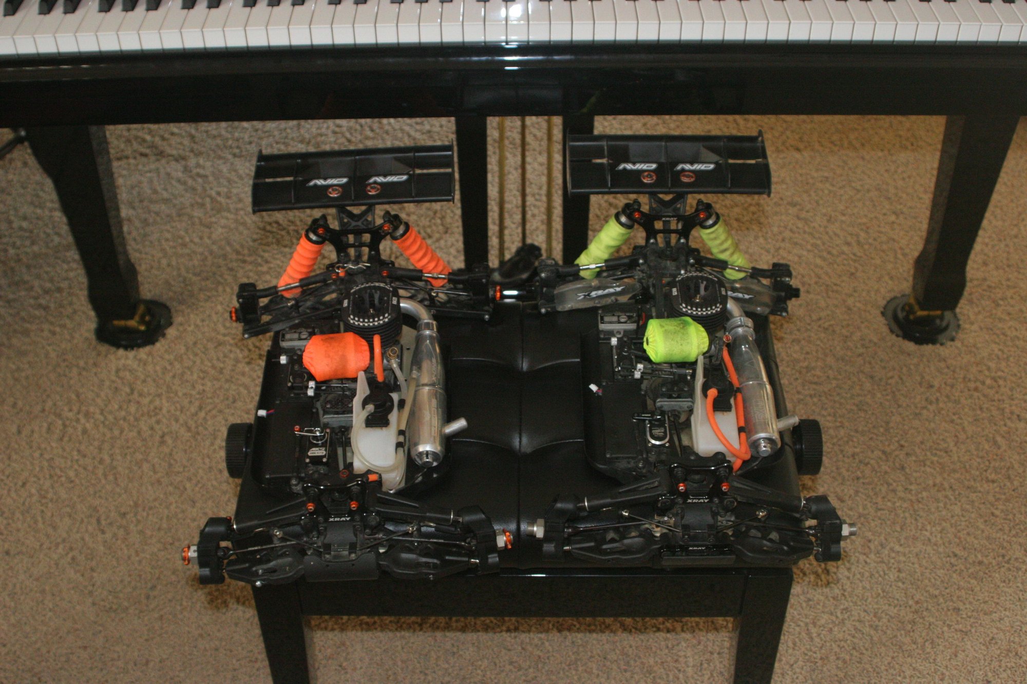

On the last run before the rain came in, I had identical setups on both buggies down to .10mm on everything! The only difference was diffs at, 5-7-3 in one car and 6-6-3 in the other. 6-6-3 won in almost every way, only a slight drop in forward acceleration. Again I'm running on a low traction track, so that forward launch doesn't help much. 6-6-3 gets me predictability and free rotation through corners, car has tons of steering on and off power.
After that I tested two different camber locations and camber deg angle settings, I ended the day back at stock. It just rotates faster in corners, and if I mind my throttle on exit just a little bit, its faster overall.
So I've picked my setup for Diffs and Camber. Now going to test the DOT 4 spring up front with lighter front sway bar. I cant imagine the car getting better, but if it does, god help the competition! lol. Also picked a tire for race day, but that one I'll keep to myself.. lol.
Also been dial'n our short bus truck, so next test day will be busy.
Front shock spring test is next up for my twins, probably not a major change, only going up one rate stiffer.
The yellow ones name is Righty Tighty, and the Orange ones name is Lefty Loosie! LOL.

Keep going up in center and front. Iíve had very good results from 10-10-6 and now have been 10-10-4 for a few months. Try it

What surface are you running that diff setup on?
That is why I have a practice car, and race car, so I can continuously test new things while maintaining my last known "best" setup for racing. I picked up some 8K oil and was about to try 8K 8K 4K. I also picked up another spare set of Diff's so I could test through combos faster. Only down side of testing new diffs is they need some "run in time" to get the mechanical bind I'm after. Takes about a day of practice to get them set.

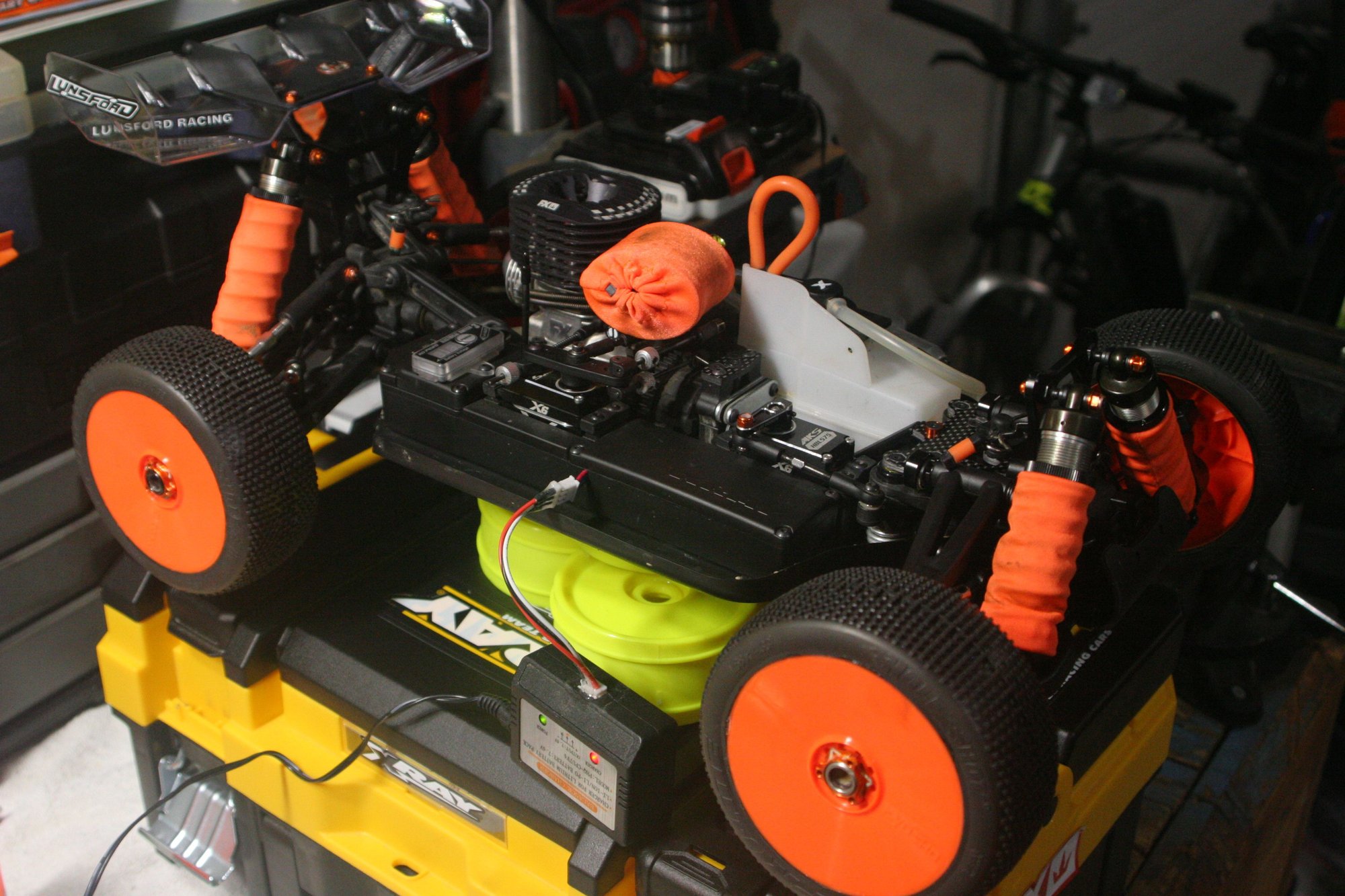

Tested,... 4 Dot springs up front are faster on my car. Running 4 Dot up front, and 3 Dot rear. Thanks to whoever mentioned to try that, was quite a while back, just got around to it now. Race is Saturday, will post setup if I top 5 or better.
Shes ready for her first race, shes a slutty kinda fast! LOL!
