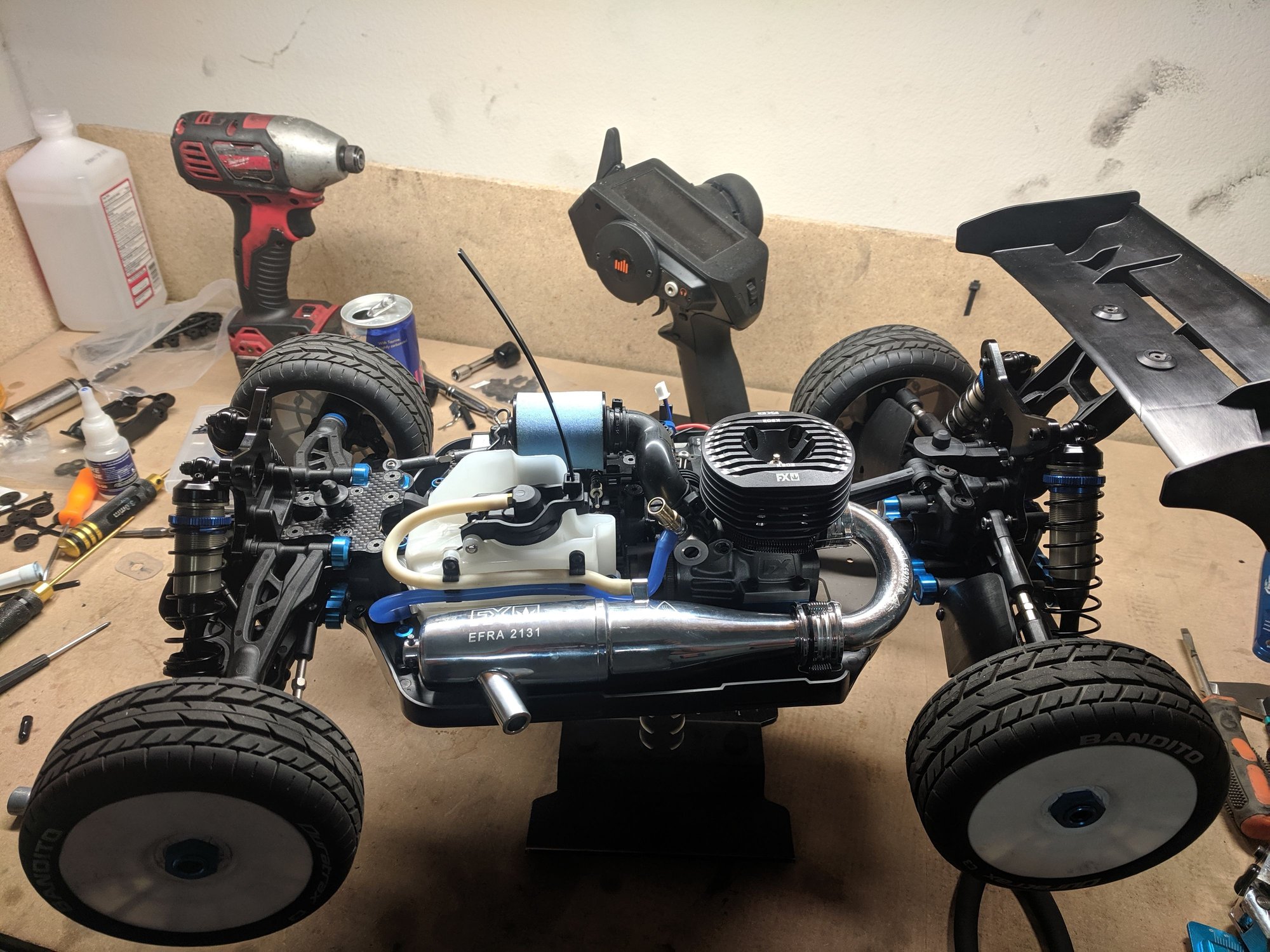

Well just got the kit and I am in the process of putting it together.
For some reason manual calls for 3k rear diff but mine came with only 5k. So I drove to AE and they gave me a 3k bottle for free. Good people.

Almost done. Tommorow I am getting my fx k302 motor cant wait to get everything running.

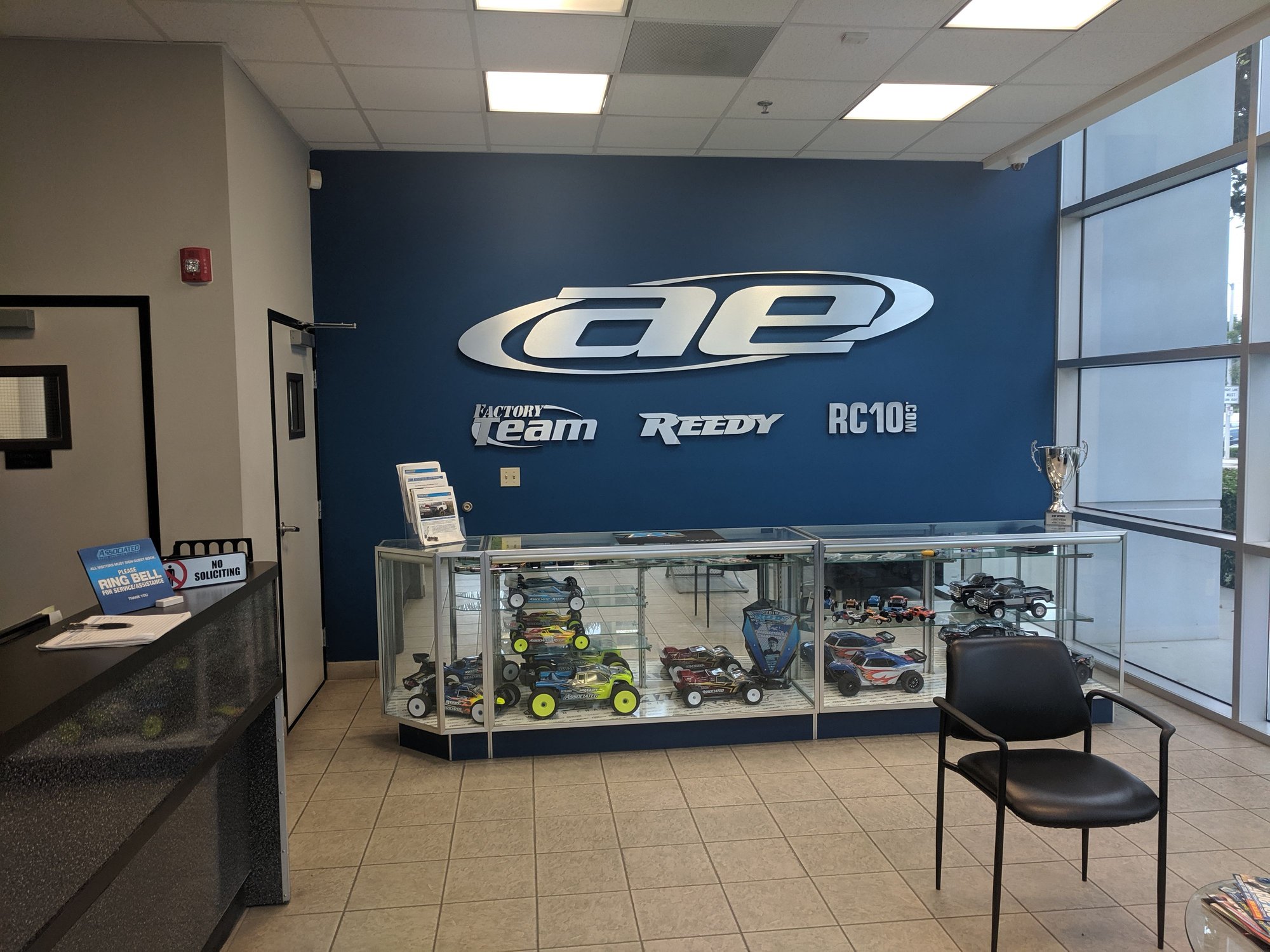

I am here at the headquarters to pick up a shock tool and couple more items. Really nice friendly helpful people.

Hey guys is it normal to have little back and fort movement on the lower arms?
Niz55 is offline
Yup. I prefer them a little loose.

Why is this happening? If the suspension is unloaded up on the stand the way it is , the left rear side does not spin. But when is on the ground it is spins fine. I checked my diff and is assembled correctly.
​​​​​​https://youtu.be/uqzyhb4M0i4
The video link doesn't work, but it sounds like you have something binding when the suspension is at full droop.

Posts: 68
Fixed.
It was the pin on the cva. I guess it was not sitting proparly. I took it out and insert the pin in another hole and all good.
Car is done. Need to paint the body and break in the engine.
