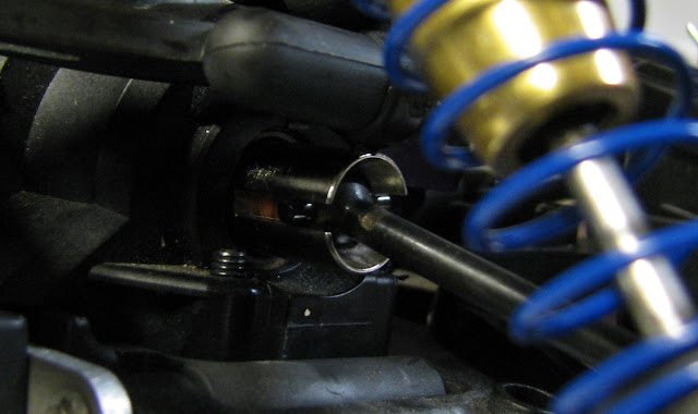

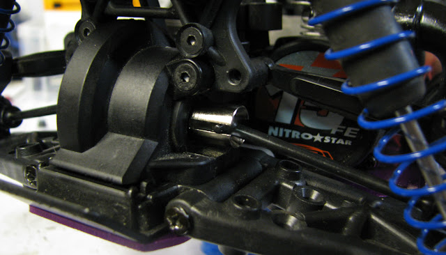

What prompted my search for driveshaft universals was the front left dogbone slipping out and re engaging randomly. I read the diff cup was too short due to the offset of the diff. The solution was to buy slightly longer diff cups from the Nitro Rush. I bought 2 sets just in case. The universals were parts for the SNRS4.
oh no! don't worry hpi, we got this.
time to open some diffs.
rush diff cups are heavy duty. these should last a long time. I hope.
done....
...and installed.
beautiful, look at all that efficiency!
oh perfect! love when things work out!
the fronts fit fine, why would they say not for the rear SNR?
oh, that's why. bummer dude.
well, good thing I bought 2 sets of diff cups. used 30k weight in diffs front and rear. not even sure they are sealed diffs...
omg, I need to high five myself for buying two sets of diff cups. I saved my day. perfect fit

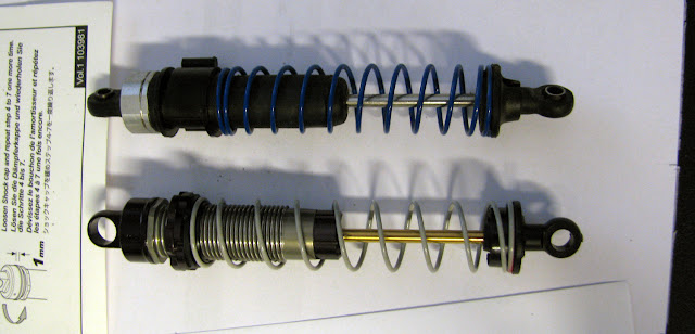

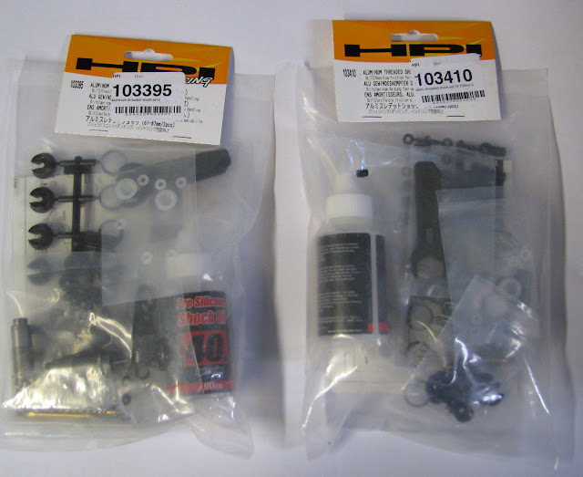

These are the aluminum upgrades for the Blitz SCT. The shock length was a match front and rear. Not sure how the weights compare as I don't have a Blitz but it seems the SCT is much lighter. I had to wind in a bunch of preload to get stock ride height. Might look for stiffer springs, might not.
front kit
these were a bit shorter(7-10mm) than the (not stock) shocks that were up front. here you can see the preload, I think I added even more after driving.
rear shocks
perfect swap, comes with mounting hardware and extra hardware. I think I only used one parts tree for both sets since front and rear used different parts from the same tree. I only used one bottle of shock oil for both sets too. preload not added here.

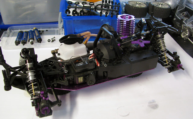

how the car sits now. you can see the preload added to all shocks, used it all.
