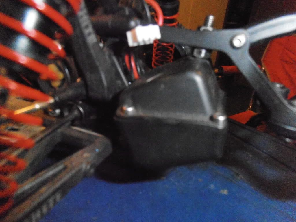

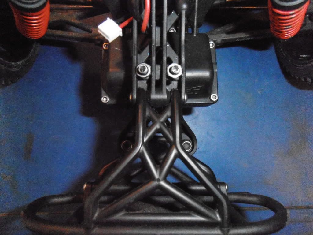

Below is better pics of rear bumper ..... what i did is drilled holes thru battery box and put counter sunk bolts thru top of cover and put nut for spacer to bumper brace and then nut on top to secure it ...
BTW the rear bumper is longer than body due to the shock tower being further back , thats why i have rear mount backwards on shock tower .. yes it fit good on with it like electric trk but i felt safer with rear bumper so dont get rear end smashed from behind LOL
