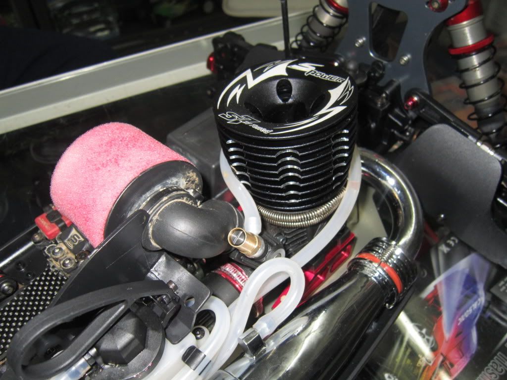

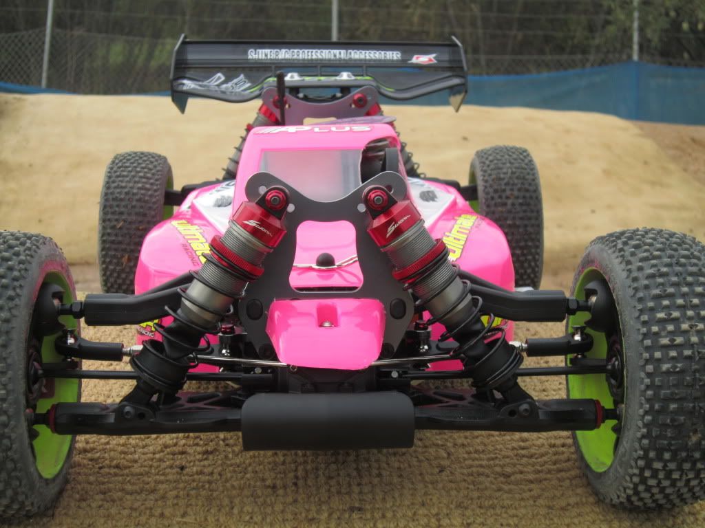

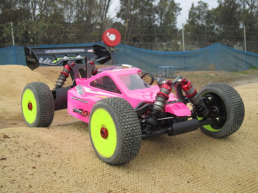

We have been running the S350 BK1 for a few weeks now in Australia and not one breakage and the car is performing really well only thing i have changed from the stock setup is the diff and shock oils i went down to 12.5k F 3K C 2K R and 350 CPS in the shocks all round and the car was awesome!
i have also been running the S-Power S7 and all i can say is this engine is lethal so much power even before full break in we have limited the throttle 50% and it still has great speed really happy with the SWORKZ Products

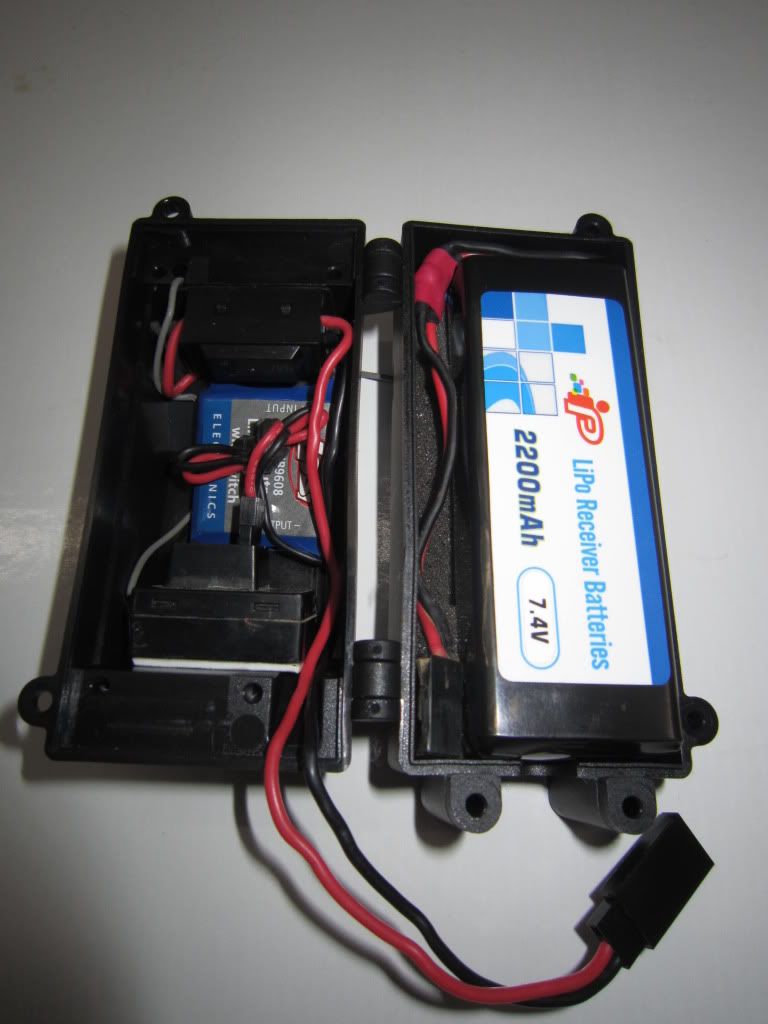

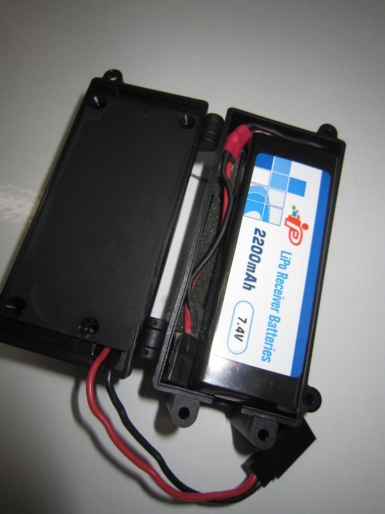

Battery box is a great design all your electronics are mounted above the battery in a sealed compartement to stop water damage.

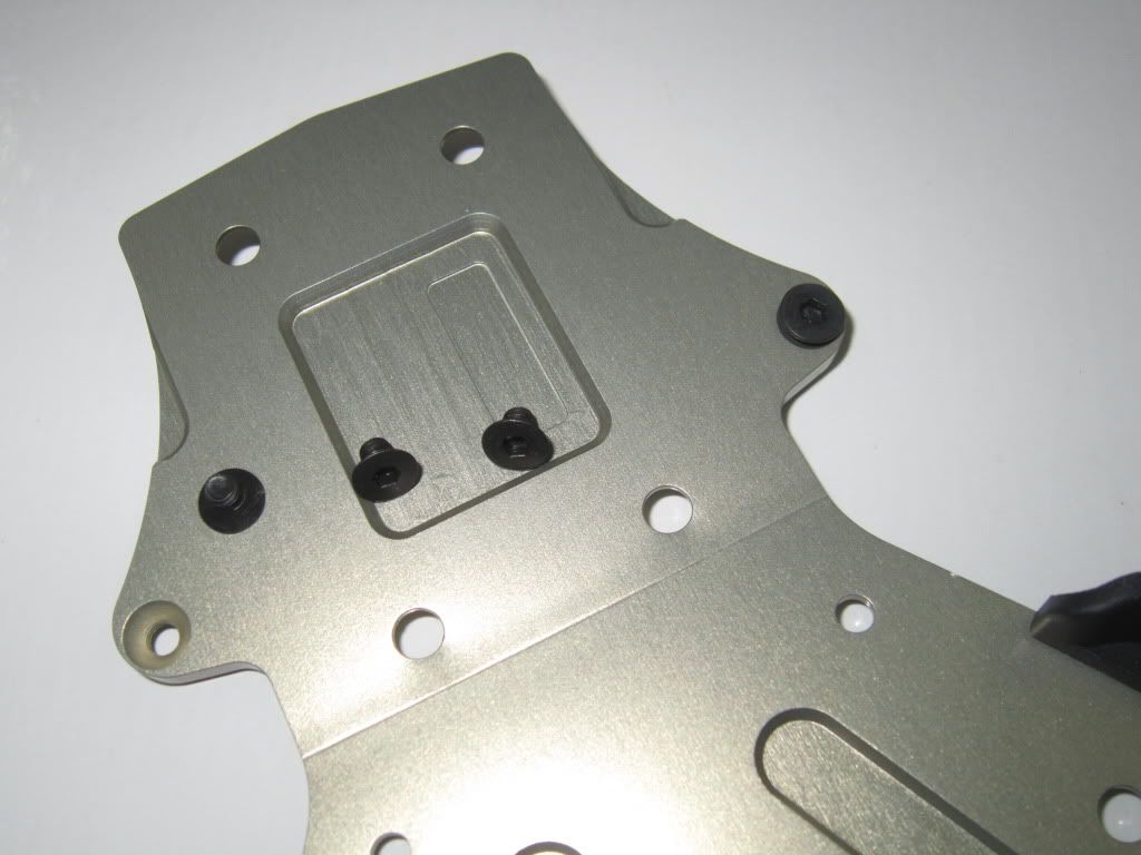

Screws are mounted into the chassis to prevent the alloy chassis being damaged from the Droop screws
