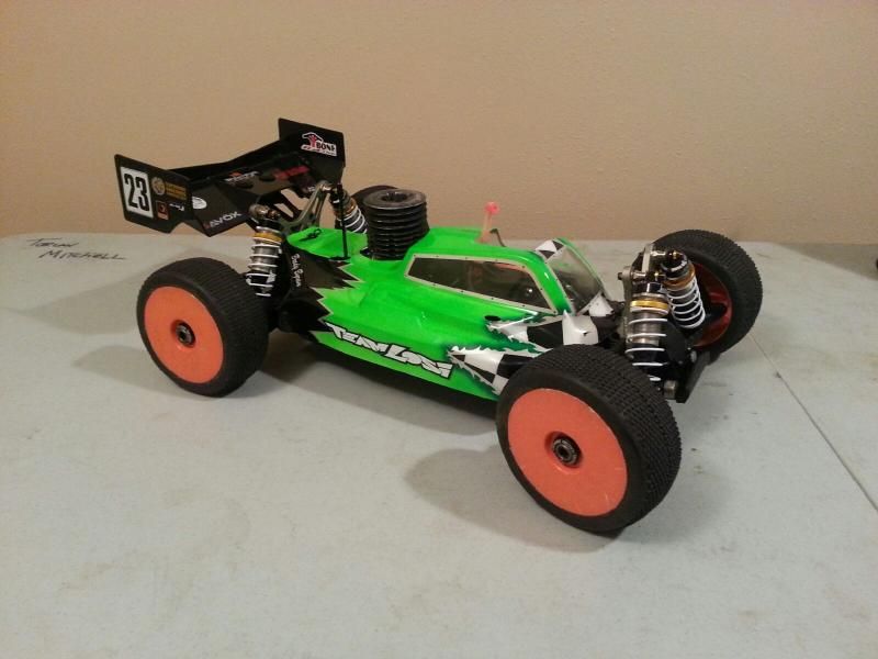

I slapped my buddies old Bitty Losi 2.0 body on. Fits well.
