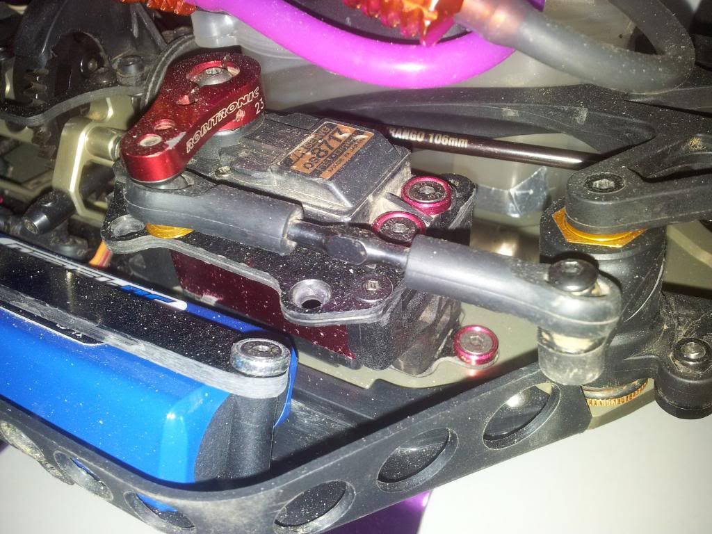

Originally Posted by Nick411
Exactly how I have mine, except I stood my servo up so I could move the battery forward a little more.
yeah great pics from Gump and everyone. Much cleaner than mine but hey, it was a quick/dirty test of battery forward.
What posts did you use to stand-up your Servo ? And can you post a pic.

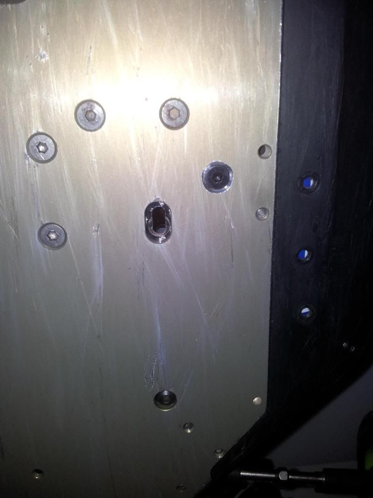

I used the front of the Mugen MBX6 servo tray, modified the rear mount so it would fit. It uses the existing front servo screw hole in the chassis, and the rear is the hole that was used to hold down the tray, just reamed out on the bottom so I could use a countersunk screw to hold the rear mount and the tray at the same time.

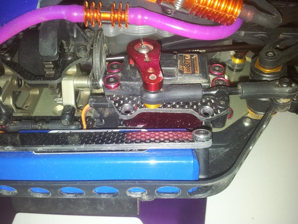

Here's what I did. All using tekno servo mounts and the stock tray and 2 risers for the fuel tank.
Attached Thumbnails Durango DNX408 - Fast enough to win the World Title.-image.jpg
GomerPile2525 is offline
Nice. Thanks guys.

My efforts today. Took an RC8 Radio tray and chopped it up. Still dont' have the buggy fully re-assembled as I'm waiting on a few parts. Advantage is it requires no extra holes in the chassis.
And yes I did clean my car.

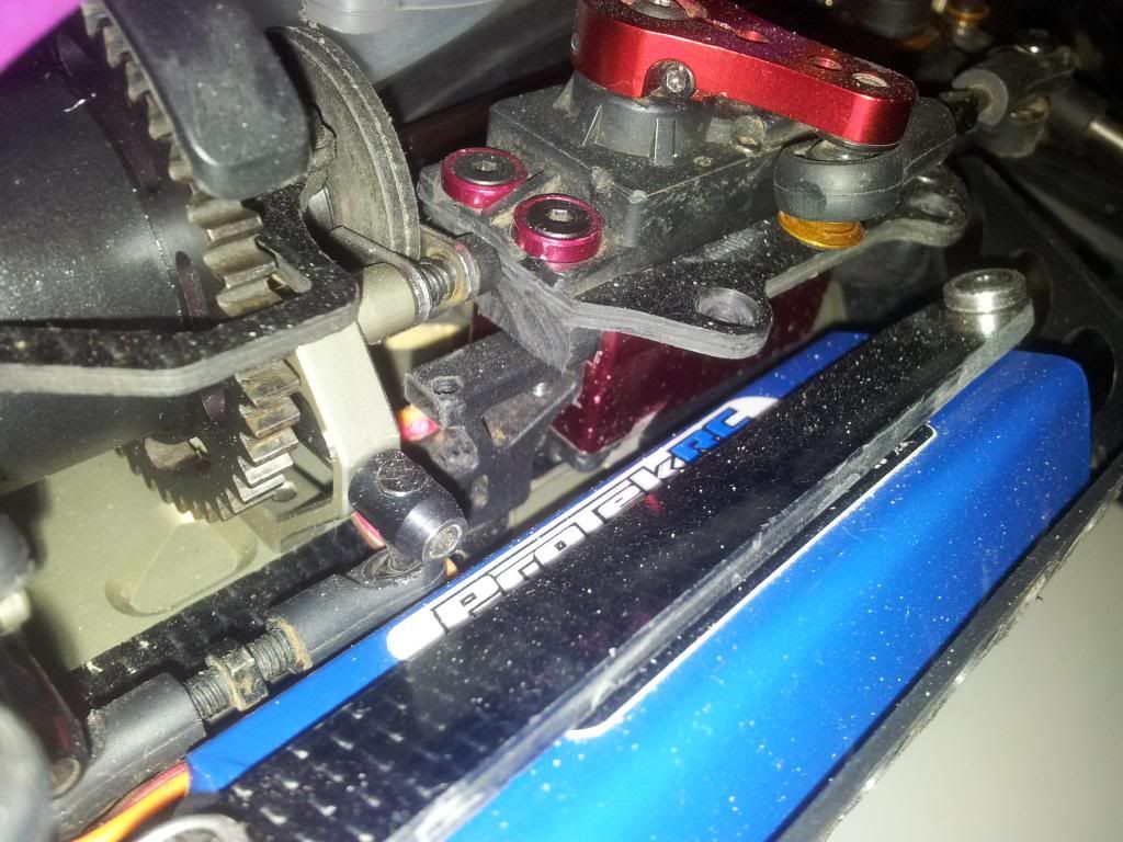

Something subtle in that picture... I shaved a few mm off the plastic servo mounts allowing me to move the servo further inboard. I also reversed the servo so the servo horn is at the front of the car not the rear. I had to use the turnbuckle from the brake to join the steering tie rod ends together (much shorter). Its all looking pretty good. Looking forward to getting it on the track this weekend at AMS.

Originally Posted by rcaddict02
Where are y'all getting the carbon fiber bracket and what did you wrap the battery with?
No carbon fiber on mine. The bracket is the aluminum battery hold down from a Caster EX1.5R cut to length. The carbon fiber is actually 3M DiNoc. The battery is wrapped in standard black shrink wrap from a local electronics supply chain called Sayal. And if anyone is interested, the plastic standoffs are RPM long shank ball ends from a 10th scale with the balls cut off the end and drilled out. They just happen to fit very nicely and were on my bench. Still looking for nice golden aluminum standoffs if anyone has a suggestion.

What is the main benefit for standing up the steering servo?
ehartman_49348 is offline
Old 03-15-2013, 09:15 AM
  #9225
Join Date: Dec 2007
Location: Spain.
Posts: 493
More room for the battery in case you want to put it in front. That's pretty much the main and only reason to do it.
