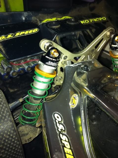

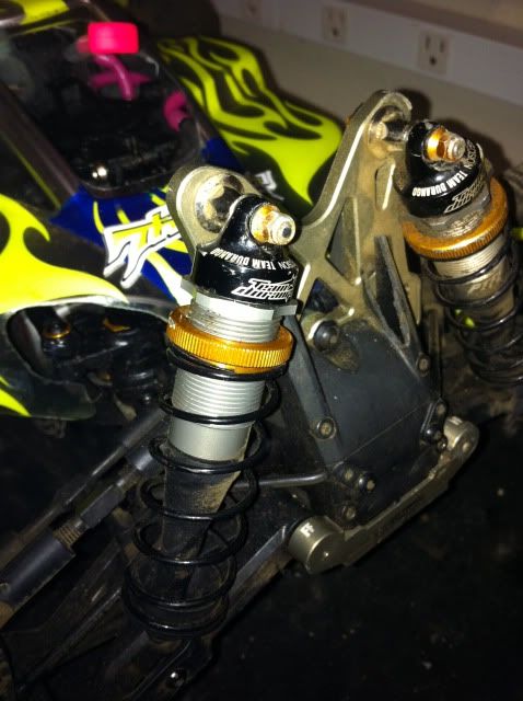

[QUOTE=waynej;8515655]
Originally Posted by Frank L
I'm using 104f and 116r for droop settings. Try that
How much preload are you running on your shocks for the setting of your ride height (running the same as you with losi green spring to the rear)?
As for shock oil trying 600 front and rear.
Front preload is 5.3mm
Rear preload is 6.0mm
Heres a pic.
