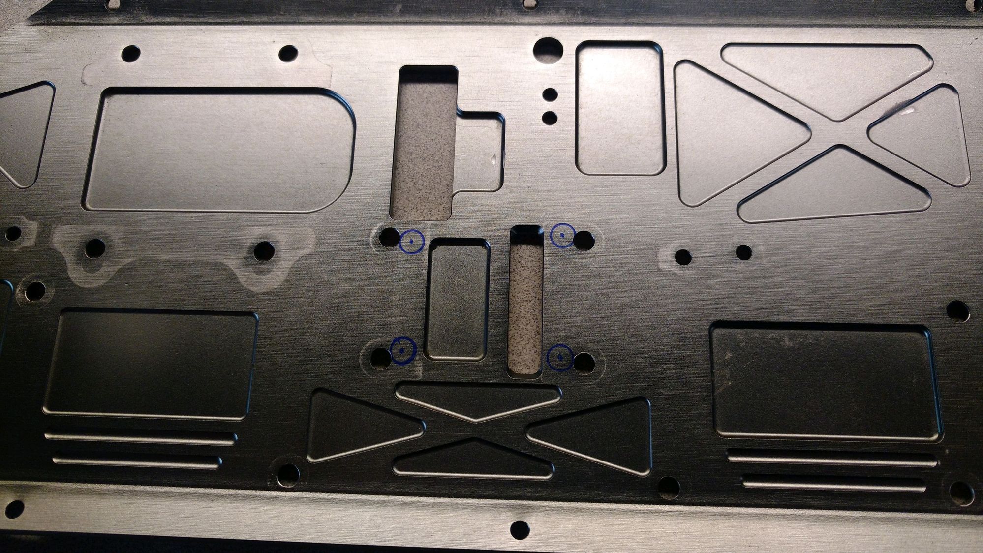

So was there a solid solution ever figured out for mounting the center diff nice and straight on the srx8 conversion for it and not at some crazy angle like posted a few pages back? Was it
just to use the srx8 complete center diff/assembly? Does dremeling still need to be done? Need this to be known before I start buying the conversion and possible headaches.

Buy the M2C conversion if you can. It was the best I ever had my 811 handling. If its not available, PM me. I have done a few and still have the template to drill out all the holes ( straight) and chamfer them. Almost looks factory...But if you are looking to possibly save the head aches, there are a couple SRX8 T's for sale I know of going for $300-500 depending on what it comes with/ use...
Thanks
Yes... You drill it in the correct location. I still have my template if you want it done. PM me.
Parts needed from the SRX8/T: Radio tray, Center diff mount with brake pads and rotors, Complete center diff and 8 M3x16 screws.
Marked...
Drilled
Chamfered...
Complete.
