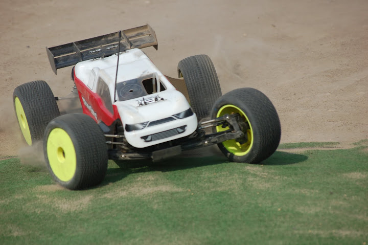

I won last two races i attended so yes, you can be competitive with 1.0T. I haven't driven 2.0T yet but heard that it is much more forgiving. I wanted to buy the 2.0 version but it's unavailible on rcmart and i don't know when it's expected to be ready to ship. Anyone has such an info?
A few photos of my 8T1.0:

nice ! are those white springs on the rear ? do you race on a rough rutty dusty track ? what springs do you use on the front ?
im running the gray springs with 35 w and the black springs on the front with 35 w .

Yes, here in Poland most of tracks are dusty with low grip. I'm quite new to nitro racing (let's say 7... maybe 8 races) and I run almost stock setup. I know it's stupid attitude to racing but i don't want to experiment with setup... It handles so good and is so predictable that i don't want to mess it up.
The springs are stock (front-black and rear-grey) and the oils are stock. The only change i made is the spring tension (i made the suspension softer -> we rarely have big jumps) and changed the ackermann to the short one. Of course i've also changed tires because the stock ones are good only for engine break-in.
This setup works very good for me now and has been working good since i started racing (2 days after the first driving i won a local race - this car is so predictable and easy to drive!).

Donat, I see the artificial turf in one picture. Do you run on the turf like they do in the UK or is it just next to the track surface?

It's some kind of a carpet and i'm glad there is only a small part of the track covered with it. I hate this part I don't feel comfortable driving on a low grip track and suddenly entering a high traction corner. The car seems to turn not so well but i can't tell you if the stock setup does it's job because it's too short section.
Photos of my local track (and the small carpet section in the top-right corner of the 1st photo):
http://picasaweb.google.pl/Donateq/F...82648537342914
http://picasaweb.google.pl/Donateq/F...82822794749826
I like technical and tight tracks. And most of tracks in Poland are technical. Thats why i'm mostly using short ackermann (IMO the difference is significant).
