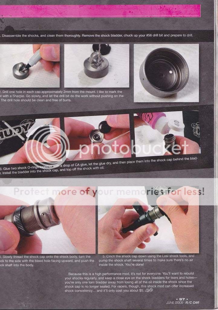

Iím sure I had read in this forum re- Foam Bladder Compensator.
The discussion covered drilling a new hole and how to go about setting up,if anyone can remember where it was posted.

i do pretty much same thing, except drill my hole in ring side of cap, and install cut down losi 2.0 euro foam compensators, but this is for my serpent 811 as well

This works on all shocks... seen it on Losi's, Jammin's. XRAYS... just makes it more consitent and linear.

If you are looking for a consistant shock system, this is it, either 10min or 45min you will feel no changes in the characteristics of the suspention while at the track. This mod is been done in on road cars for a while, now in buggys, why? because work.

u can also do it without drilling the hole in the top
