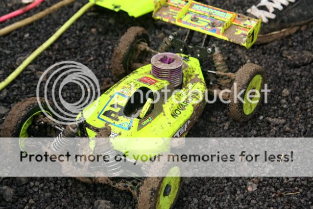

Adam Drake used these @ the warmup for Nats.They are super skinny
I think they cut the wheel or something like that. they did it at worlds back in 08
