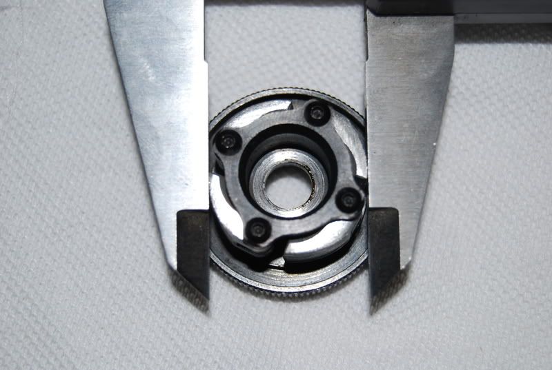

For for the 8ight t 2.0 are people using the losi high endurance clutch bell with the max life clutch? That is what i was using.
Also, does Adam Drake's 23.4mm measurement hold water with a max life clutch or is that for losi clutches? How do i know if my max life is worn out? Thanks.

I still dont understand the measurement, I use them for 2 gallons and change them regardless, thats me...
Dyn shoes with HD bell and green and gold springs....

Posts: 295
thats the measurement, 23.4mm.
Right but i have a max life clutch with 2/3 a gallon thru it measuring 23.13mm. Makes no sense. I know i'm using the silver springs but i don't think it should wear that quick. Not sure if Drake's 23.4mm measurement is for the max life clutch. I need to measure the new one once its put in and compared to the one with 2/3 a gallon on it.

here's the deal with the silver springs..
confirmed with TOKEN, the RCT "yoda" i call him, the silver springs have the highest tension, so in order for the shoes to engage the bell, the engine must REV higher, and the contact of a stalled bell housing is very intense. alot of heat, alot of friction. even off throttle, and on, its high revolutions, and some slippage.
now, with the softest spring.. its going to put the bottom end of the motor to work. instead of high RPM's.. its really LOW. clutches engage very soon, at a lower RPM. slower contact speed, and rarley does the bell get as hot as it normally would with sliver, or gold springs. the drawback to the softer springs, you need alot of bottom end tourqe, and you get really really good traction, so tire bite is crucial.
so, hard springs.. silver/gold, its going to wear your shoes quicker.
soft springs.. green/black, last longer, but could loose lose end, off the line speed.
i run black and green.. most like green and gold. hope this makes sense.
