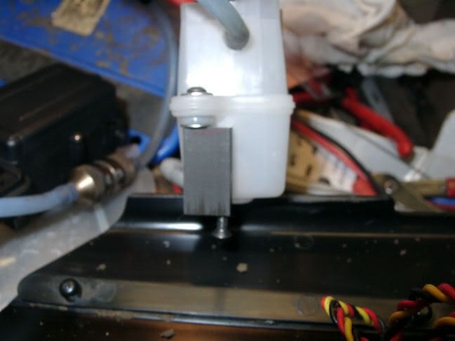

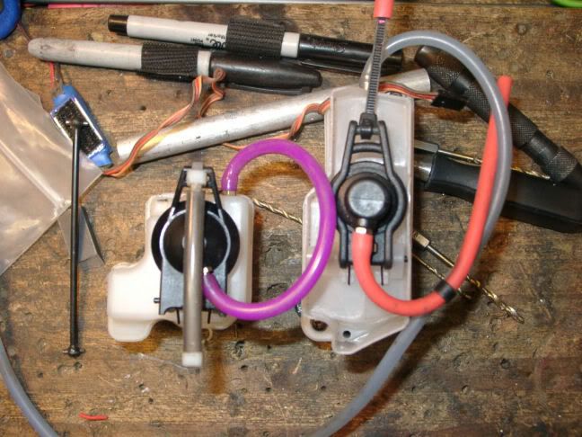

First, the stock CRT.5 fuel tank is 75cc (pretty small), I am pretty sure the factory nitro SCRT will have a bigger tank because the holes in the chassis do not line up with a stock CRT.5 tank. What I did was dig in the parts bin and I found a 125cc tank off of a CEN buggy that was almost a perfect fit. I just needed to move the rear mount over about 1/8" (see the pictures).

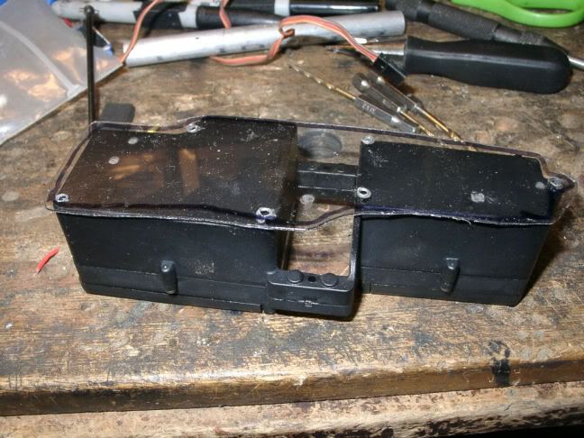

Next the CRT.5 battery box is too small and won't allow me to install a battery and rx in the box. So again into the parts bin and I found a box from a SH Z-Car that was a good fit. I had to drill a few holes and I used a technique I learned from the numerous brushless conversion I have performed in the past. To get the holes to line up I made a template from a lexan scrap, I put it on the item (batt/rx tray) and marked where the holes were. I then drilled small pilot holes in the lexan. Next I placed the template on the chassis and marked the hole locations. Drilled and beveled the holes and they matched the new box perfectly.

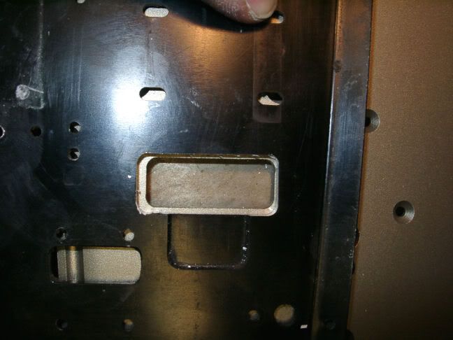

Last, the CRT.5 mini starter box is too small and I had to manually line up the wheel to start the engine. I want to use a standard starter box so I opened the hole in the chassis slightly and got it to fit on my standard starter box.

Making a template for drilling holes in the chassis. Placed the clear lexan on the batt/rx box and marked the hole locations.
Place the template on the chassis and marked the holes.
Had to move the rear mount over slightly, instead of drilling a new hole, I made a new mount with screws that were off-set.
Opened up the hole so a standard starter box would work.
New 125cc tank next to the CRT.5 75cc tank.
