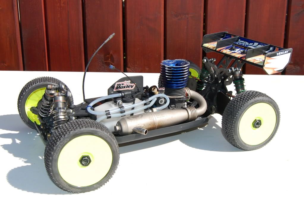

there's a sweet spot for length on fuel line....Too short and it wont run right....too long and same deal...it'll have an adverse effect on the motor....8-10" is what i normally do for fuel/pressure line...here's a pic for reference...not the best but it shows the lines.
Keep in mind the losi has a good 3-4" worth of line IN the tank.

integra. thanks for the pic. the ofna car is quite a bit different set up. the fuel supply line comes from the rear of the tank, from the top and the pressure line comes from the front of the cap like your losi. There is a big loop from the supply outlet on the tank to the carb. a 2' piece of tube with bridge the gap, but as everyone here states, you need the extra tubing in case the car gets upside down it will help keep the motor running.
The ofna car just looks a little cluttered and the fuel supply and pressure lines might have been resting on the exhaust and i don't want a hot exhaust burning through a fuel line. i rerouted them but have a hard time priming the carb. some of that stems from the pull starter slipping and some i figured might just simply lie in the fact that the fuel line was too long. looks like i need to get that pull starter fixed and check for other air leaks i see. where should I be looking for air leaks?
