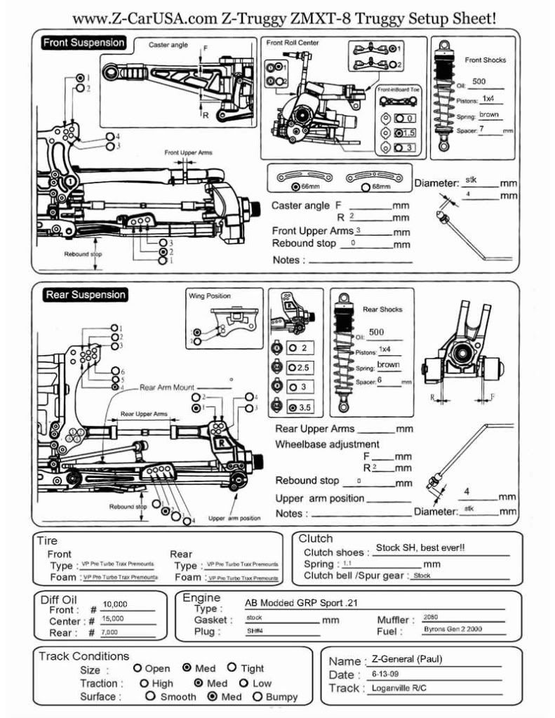

Paul,
can you post your set up on the truggy? It's close but fought it all weekend during our trophy race. I actually pulled it off during the b-main, it was tickin me off so bad. On the up side I pulled off a third place finish in Buggy

WOW! What was it doing/not doing?
Good to hear about your buggy finish, but I am concerned about the truggy issues?
You are running the brown springs (stiff) front and rear, right?

The rear toe is incorrect, its at 2.5, not 3.5 as I accidentially filled out.
I will do a current one and post it soon

The suspension was just off. I kept ending up on my lid. Not sure if it was oil choice or hole locations. I also shorten the wheel base front and back as the track had a few winding sections. I'm running the stock springs that came with the kit.

Oh man the stock springs are too soft, I ran them for one race and it wallowed because of them.
