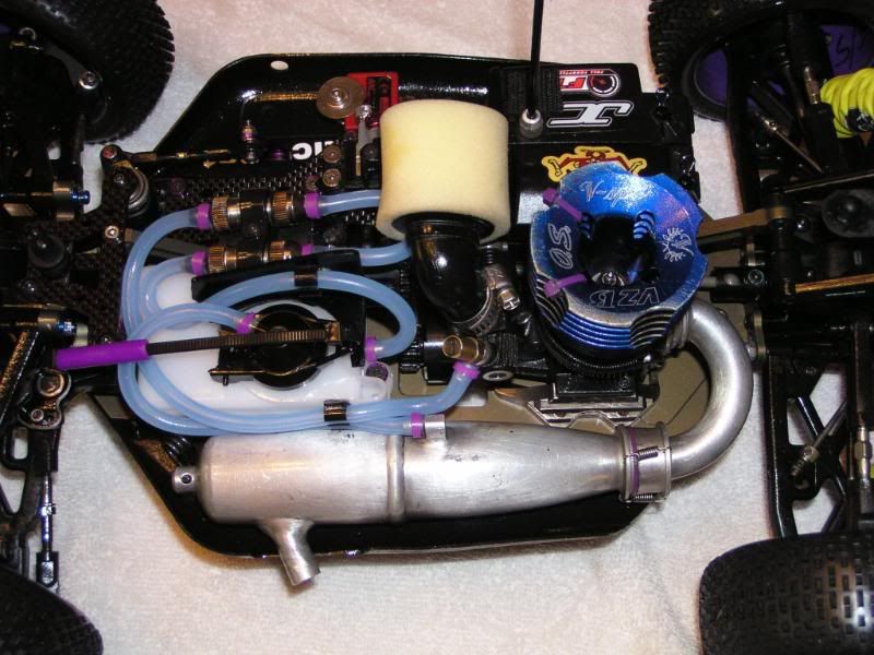

Brand new..

Very cool bro. What is the big washer on the transponder all about?
Not too sure about the filter securing method... That steel hose clamp might not be the lightest thing in the world, but I highly doubt that filter is coming off any time soon! Did you run outta zip-ties and steal it off your real car's filter, or is it simply a personal preference?
And are you having trouble with run-time with that O.S. or are you just running two fuel filters in case you get stuck without a marshall for too long? does the car have a problem with flaming out if noone gets to it right away? I hate running external fuel filters, and would rather not, if I can help it. Does a little extra fuel line help enough, or do you really need extra like that? They're just extra weight, they have the ability to pop loose, or get an air leak, or split in the line at the entrance... all kinds of things that you can avoid by skipping them altogether. Does anybody else run a fuel filter? Does the car come with a dual-fuel filter setup like that? Isn't the spring-type pipe-mounting wire really heavy compared to just a straight wire? It does give you a kinda cool place to route your fuel line (if you use it...) Does anybody have a good photo of Chad's car without the body on? I'd just like to see a couple things.
I don't want you to think I'm picking apart your chassis or setup too much just to be a dick> I'm just a little paranoid about extra weight now, coming from the D8. I'm always looking for ways to drop a few grams if possible...

Large washer on PT- I do not wants the aliens to get my PT number (I also Wear a Tin Foil Hat so they cannot read my Mind) No Really the mount eyes broke, and I made due with what I had on hand, Its the same radio tray from my X1, been like that for over a year...
Fuel- still spec under 125 -9 min run time easy, The filters are empty(No Stone) I seal them up like the engine. They are just lil fuel tanksCurrently running Tuned GRP, 10 min Run time
Hose Clamp- Yep, It is from my service truck (Diesel Mechanic) never had one come off yet!
Weight- 7.6oz Dry..It is a lil heavy But I am not very diet freindly in my eating habits, or car set up.
Tube...I just change it and do not have many issues with splits and such. I buy those 100' rolls, I do a complete tear down every three races, new line goes on.
Pipe- The spring ones seem to not snap if you get kidney punched, or used as a berm Nothin worse than trying to finish a heat with your pipe floppin round...
I like durability...weight aside...To finish first, First one must FINISH.
I do not take much personal, I play with my cars cause they are fun, I race to have fun, wining is just an added bonus...I chitty chat on here cause its also fun, sure as heck beats workin...
