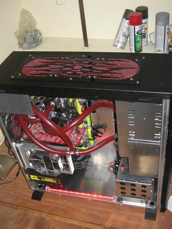

Trader Rating: 14 (89%+)
Here's a few more pictures of my "blinged" PC
But seriously, the $ I've made after people see it and want something like it more than paid for what it cost me to build it
The Stealthed DVD burner
Before the mod
The internal radiator with 3x120mm fans custom installed into the top of course
Sleeved and hid all the wiring behind the motherboard tray
This thing is HOT
