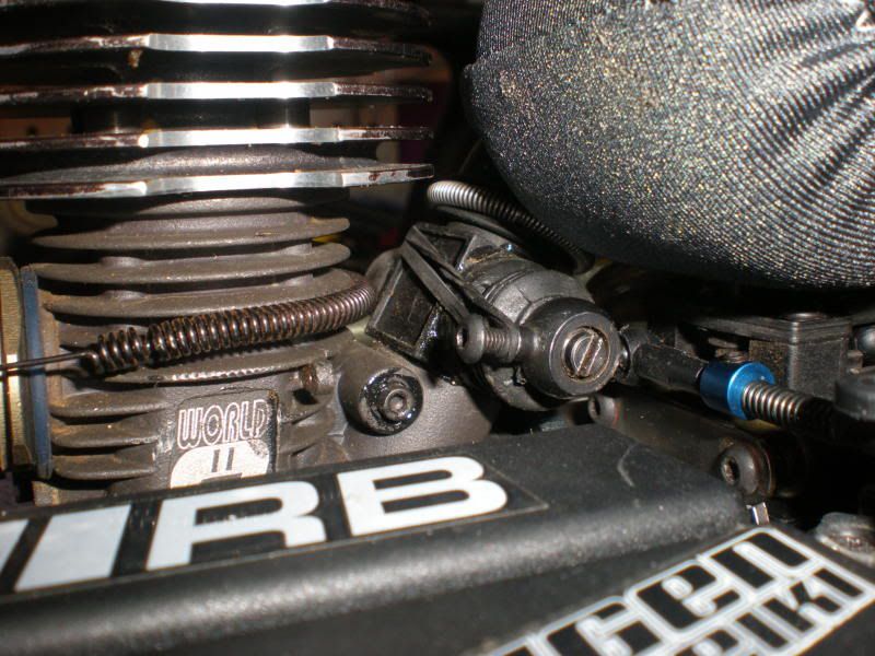

These are the carb O's like above, but got them at wal-mart cheaper.
I took out the set screw and put in a button head screw and used 2 bands,
snaps the carb shut and don't bind.

Hey that is a pretty good idea for several reasons:
1) That little set screw is prone to stripping anyway.
2) Rubber bands on the ball linkage side can interfere with the fit of the ball linkage
3) Easier to tell if there is a problem if the rubber band isn't on the ball linkage.
4) You can add or remove rubber bands (i.e. change old ones or alter amount of tension) without messing with the ball linkage.

I tried that method last year with a spring and it worked awesome. No binding. I am going to try the bands this year and hadn't switched out the screw yet on a new engine and tried a band and it bound up the slide right away. Plus I didn't like the band rubbing on the rubber boot so much. Each engine is just a little bit different too I guess. At least pics make it look like they have small differences.
Are you guys setting the band tension enough so that if the battery pack becomes severed that the bands will overcome the dead servo and pull both the carb and servo back?
I had that happen to me last season and the spring I was using all season had not been put back on that time stretched tight enough and I had a 1/4 throttle run away into the weeds. Landed a jump, battery leads pinched and broke, and went right off the next berm into the weeds about 10mph. You have to set the bands stonger that just to return the carb like if the link would pop off the carb with no radio problems. I am using a fail safe too but only a strong return band will save a failed battery pack. You have at least 3 ways for a runaway to occur.

The tension of a dead servo is very difficult to overcome with a spring/band. If you put that much return tension on, the servo will be fighting the spring/band too hard and it will overstress the servo. The return spring is there just to prevent a runaway if the throttle linkage should become disconnected or breaks.
Good thing you get a lot of those latex #10 rubber bands - you'll be changing them all the time...
I replace the ball end setscrew with a 3mm x 4mm/6mm buttonhead as shown in the pics, and it is the only way to go when running a band as a return device, especially on the Losi cars/trucks.
