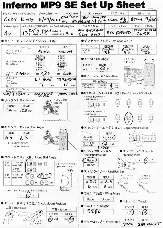

Hi guys. Here is Cody's set-up from the Nats:
I actually wished we had moved the sway bar balls in a little like Jared did, just because the track was so gummy, and Cody had too much traction. Anyhow, our set-up uses Kyosho oil which might be useful. Also, we run the rear camber link short, and that is a typical thing for us. We also used normal gearing, 46 tooth spur, which we actually thought about changing it, but felt like it would change the feeling of the car too much so left it alone. We use the medium green spring in the back, and Jared uses the light blue with the upper shock mount in one hole from where we have it. Last but not least, we used the new 2mm off-set rear hub, and Jared ran the old geometry. I don't think there is a huge difference in the way the car feels with the new rear hub to be honest.
