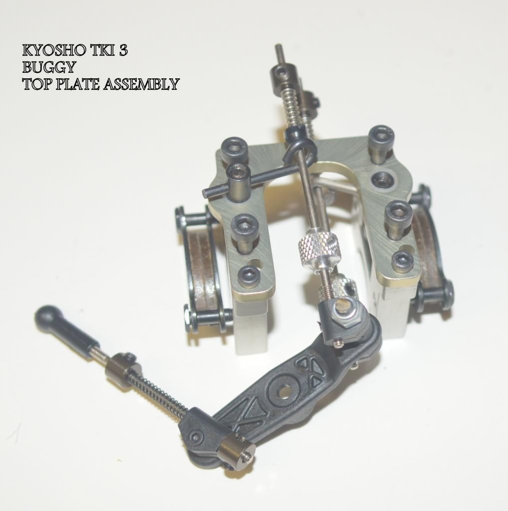

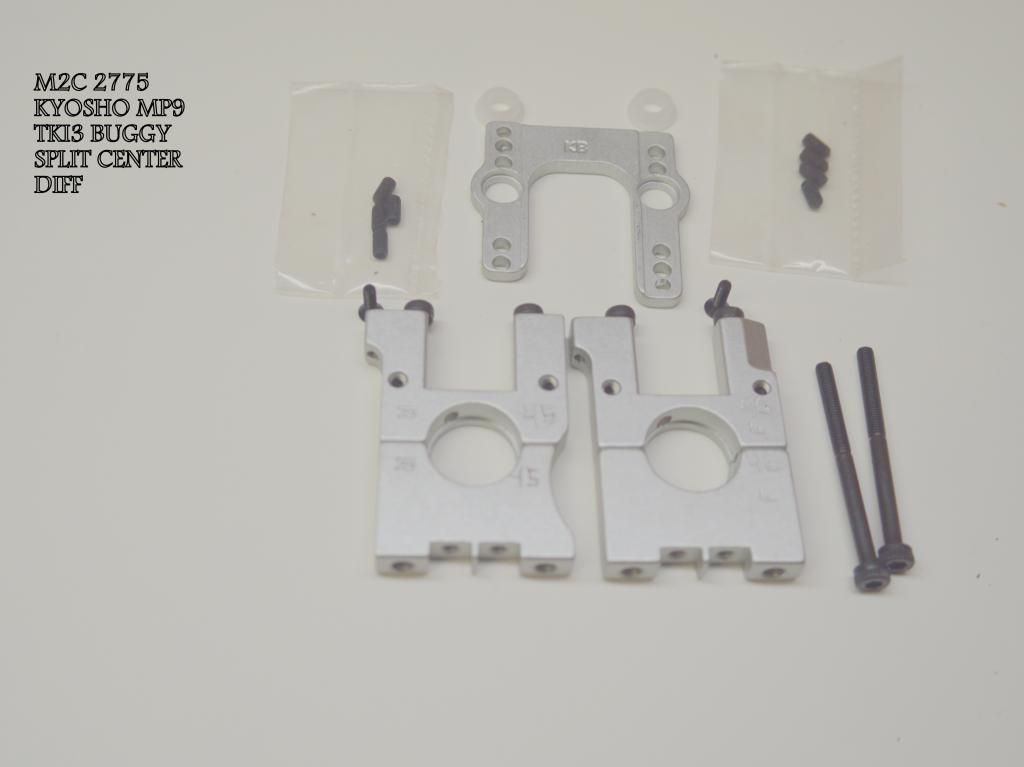

M2C RACING is please to announce the release of our split center diff for the
Kyosho mp9 tki3 buggy.
made with 6061 aluminum and clear anodized, this part allows you to simply
remove the throttle servo and (4) top screws and you have access to the
center diff. this will make it much easier to change diff fluids and inspect
the drive pins.
the kit also contains custom made delrin brake cam bushings for long life.
These bushings will not fit the stock center diff top plate.
awesome! Please make extra front ones and market for ebuggy
I need and extra front one

awesome! Please make extra front ones and market for buggy
not sure what you are talking about here. If you are referring to the front
block to use on the E buggy. Right now it will not work as there is not enough
room to get the diff to turn out of the rear bearing fit, but I am looking into
it for the E buggy also. I would probably have to make a new rear block also.
but I think it can be done.

How is the fioroni different from the m2c center diff? Been thinking to get one.
aloksatoor is offline
Old 09-29-2014, 03:08 PM
  #17862
iTrader: (21)
Join Date: Sep 2010
Location: So Cal
Posts: 1,953
Trader Rating: 21 (100%+)
It's probably half the price lol
