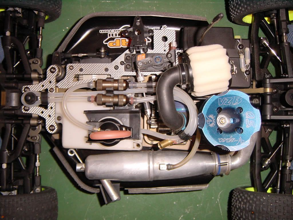

Originally Posted by Jason View Post
Crocket - Can you post more pictures of your fuel line layout?
Hi Jason,
I changed the way I run my fuel lines this week so cant show you any new photos however I can show you a photo of my last car as the fuel line layout is clearer. The only difference I made in my Kyosho is I mounted the filters on top of each other. One filter is in the fuel line the other is in the pressure line and is missing the internal filter so is simply an expansion chamber.
I ran the fuel line all the way to the front body mount to maximise the fuel I could run however due to this I was running right on the 125ml limit so decided to shorten the lines to comfortable keep under the limit.
regards.........dave
