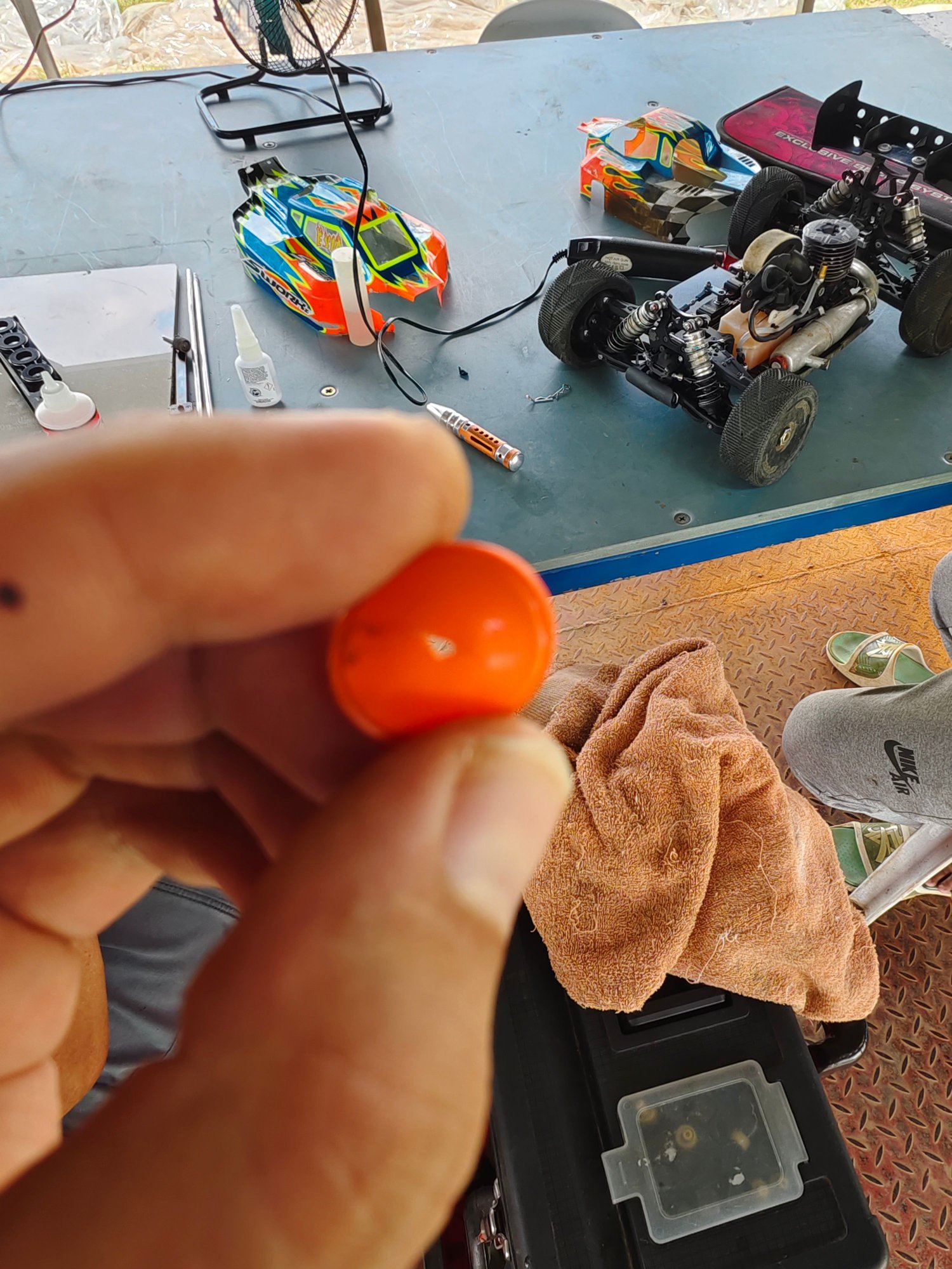

My friend got the car to test, and I'm not really too impressed with it. However I can't really speak for him. The front of the car lacks droop, and the shock body is way too short. They even suggest to unscrew the lower shock ends for more droop, but the shock body is soo short. Even if you don't run the bladder, the piston comes out of the body way too much. Adding limiters isn't an option ,as it already has a lack of both travel, and droop for tracks with big jumps. What my buddy ended up doing was machining new shock bodies that are 5mm longer, and now it's perfect. Plenty of droop, and allows the shock shaft included with his kit to have full range of travel without hitting the cap, and he can run it with or without the bladder now without the worry of it being pierced. I don't really understand why they went with such a short body in the front, when the rear has plenty of droop. Even with the lower shock ends not unscrewed the body is way too short.
Kinda weird miss eh

Originally Posted by captain america
The Nemo team have been testing the car for a while, so I suspect there's a reason for the shorter shock bodies (even if it's just minor weight savings.) Is the perceived lack of droop the only thing you were unimpressed with? I'm more curious to know how the car handles (corner entry/midpoint/ corner exit, acceleration, braking, rough vs bumpy surfaces, etc.) and utimately, what kind of lap times it can achieve compared to other buggies.
don't forget the hole in the bladder cause by this

The punctured bladder wouldn't be caused by lack of droop, but by the shock piston retaining nut hitting the bladder upon uptravel/shock compression. It could be a design issue, defective part, or user error. I wasn't there, so I can't comment. I suppose that's one way to test an emulsion bladder!
